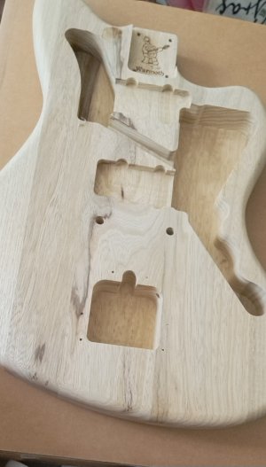

I already have pickups, necks are fungible, I don't yet have wiring or bridge I'm thinking red transparent , won't start on this one till later.

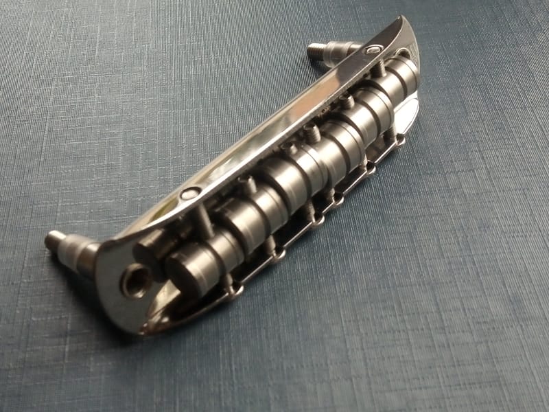

I'm working on this one slowly, now looking at bridges, any suggestions of pound for the dollar, best buy for the money, suggestions for jazzmaster bridge? Also the wood spoke to me and its not going to be red
What fretboard radius neck are going to use? A lot of JM bridges are made for 9.5" radius. If you're going with a wider/compound radius that will limit the options
The Staytrem bridge gets a lot of praise in the offset community for being nicer than most but not crazy expensive. 9.5" or 7.25" radius
The Fender Am Pro JM bridge gets good marks too but is also only 9.5" radius
Warmoth's "Modified Mustang" might be the best affordable option for adjustable radius
On my JM build I used a (pricey but beautifully made) Descendent "Universal Companion" bridge
Also, I like the idea of not going red on the body (y)
I am using a standard warmoth 10-16 radius, thanks for your post, never owned a jazzmaster and didn't know about the radius issue,. In my spare parts I have a golden age roller bridge from stewmac and was hoping I could use it. And I'm torn between the tremolo and a hard tail. Vandyke has a hard tail available
