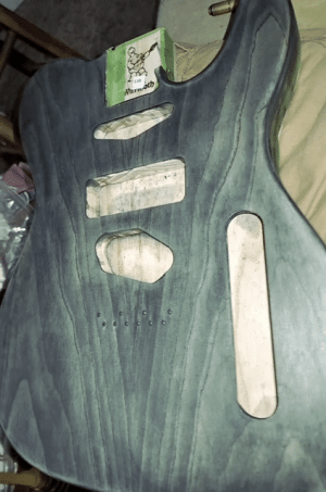

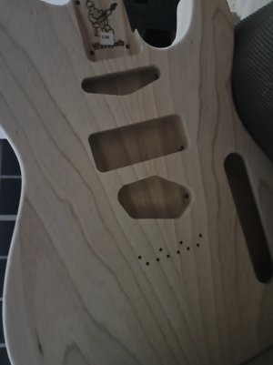

I have 2 sets of porter t90s , however, as obviously visible, I have a middle pickup Charlie christian route. A question about wiring, can you wire as a straight tele with an added les Paul toggle for cc / cc + tele, tele or would ibe better off buying the 7way harness?
Not familiar with t90s nor have i ever wired a cc pickup. Assuming these are single coils I'd get a Freeway 3b3 switch and wire it for b, b+n, n, n+m, m, and m+b. 1 vol, 1 tone.
The LP toggle is perfect for that wiring solution. Wire the hot lead from the 3 way switch to one side of the switch, the CC to the other, and the middle lugs get soldered together and run to the input lug of the volume pot.

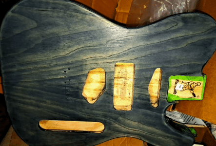

Ist day of dying * the boss says she wants me to do this one black, the minority, me, would like to add some yellow
