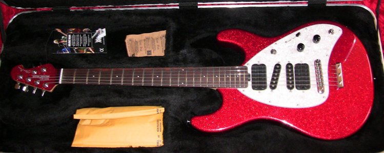

Here is the Morse I used to own. A collector bought it from me.
Very cool, I have never seen a red one!

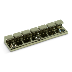

I’m not sure on the tailpiece, possibly something like this WD part:
EBMM won’t sell me an actual Morse unit sadly, but the construction looks quite simple so I might have one made at a local machine shop… seems that could be overkill though.

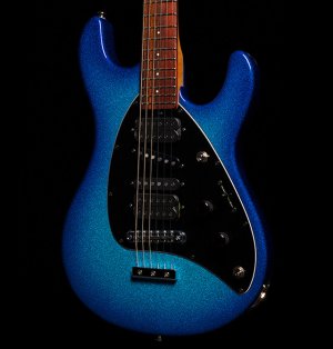

Fine axes to emulate. The Morse Y2D model in the Purple Sunset finish was my inspiration for this body I had Warmoth do, which was subsequently offered as Warmoth's Purple Burst finish option:
Thanks, all. The colour is Cardinal Red Sparkle. It was a Premier Dealer Network limited colour a few years ago. Hence, why I was contacted by a collector via TGP as I recall, as he was missing that colour.

I have to retract my previous statement - you simply need to call MusicMan and ask for part M05133 to get a Morse tailpiece. I went ahead and ordered the two toggle switches from MM as well.
I did wonder because I thought someone on the forum several years ago had ordered one. I thought perhaps you had contacted them earlier and they were no longer available.

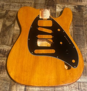

I also have a Morse pickguard here to use for templating purposes, but I thought I’d see how I liked the shape over a Tele. I gotta say, although I had intended on doing a different shape with the horn included, I really like this look and might end up sticking with something very close:

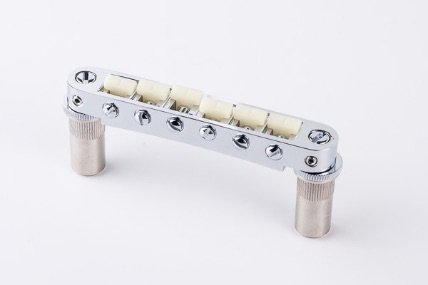

Morse also commented in an interview that the during the first Dregs albums, the bridge had nylon saddles (I imagine this came from the same 335 as the PAF?) which he preferred over the metal saddles that were fit later. The EBMM model uses a Tonepros T3BT, so I might go with their TPFG model:

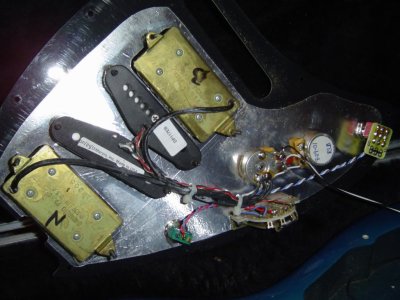

What have you settled on for the other single coil, which is a proprietary wind, the HS3 DP117? Apparently, the proprietary wind is similar to the HS3 wired as non-noiseless.
I would doubt the DP175 is going to make any real appreciable difference.
I might, but I also like the way the original frankenTele has that flash of chrome and I do have a spare Tele neck (Wilde Microcoil T) sitting in my parts bin currently.
However, this picture leads me to believe the DP117 is the more ”accurate” pick:
