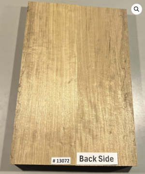

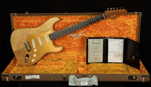

This time I plan to procure a LIGHTWEIGHT piece of piece of white korina and make a new JM body. For aesthetics I want to copy this very tasty Custom Shop strat:
Natural korina body, gold guard, cream plastics, roasted maple neck with an ebony board :love:

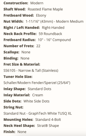

I'd seen roasted birds-eye maple pop up on the Warmoth Instagram page and thought that that might be super sexy on this build so I shot the big W an email and they said they could do one for me! I wasn't planning on ordering a neck right away, but well... I just did it. 🤘

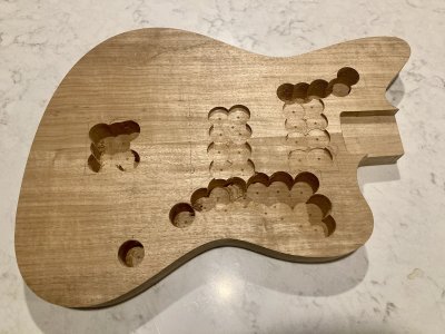

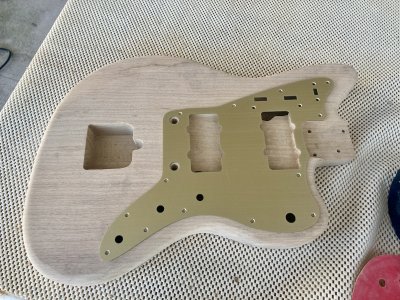

Thanks guys! I also did some forstner-ing and routed the neck pocket. I wanted a slight neck angle, so I put a small metal straight edge ruler under the neck pocket template to give it a bit of an angle and I think that worked out well! Using the neck from another build I found that the neck pocket is a tad looser than I'd like, but the angle seems to be good. With a long straight edge on the fretboard I found the height at the bridge to be a little under 3/4".
