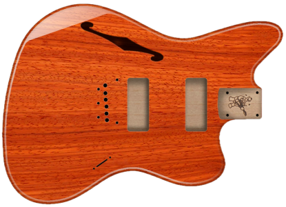

I'm wanting to build a 12-string, using a chambered Jazzmaster body with a maple core and a padauk top.
The neck will be either maple or padauk, with a canary fretboard. It will be the one with the straight headstock.
Since the body will be chambered, and the neck having twice as many tuners, should I be concerned about neck dive? Should I go with a solid Jazzmaster body instead? I was thinking about that, but I don't want the body to be too heavy. Anything around 4 pounds would be OK.
I have attached a picture of the body and neck to be made.

Generally speaking, to avoid neck dive you want the upper horn (where the strap button is) to be over the 12th fret or longer. This body doesn't look like that will be the case, so you can probably expect the headstock to want to head towards the floor. If you want to stick with that body I'd for sure get the solid version - if available. And you'd still probably have some neck dive, just not as pronounced.

From my research, the Jazzmaster body is larger and heavier than a Strat body; thus the reason I prefer the Jazz body for this build.
I have a chambered jazzmaster in basswood with a maple top. It has heavy locking tuners and Floyd nut on a larger headstock. No neck dive here. I would worry about it.
It does not appear to be a tank, check solid body weight difference - may not be that great and saves money. How secure the strap is attached is a concern...let the ordering begin.

It's not about weight. It's about weight distribution in relation to the balance-points where the strap buttons are located. LP and Explorer designs have an unusual amount of weight behind the bridge. So much so, in fact, that they often are "body heavy", causing the neck to "dive" upwards when played seated.
Most Fender designs aren't like that.
For example, compare an LP to a Tele. Similar single-cut body styles. LP's balance well, but Tele's can sometimes be just a bit neck-heavy because they don't have all that weight distributed behind the bridge.
As far as the question at hand, Jazzmasters are probably the Fender design with the most weight behind the bridge, but you are removing 25% of that weight by chambering it and then putting six extra tuner's worth of weight at the extreme opposite end.
So, in short, who knows? To determine this answer you'll likely have to build one and see.
Welcome to R&D, baby! ;)

Yes, body weight is part of the equation, which is why I said I'd go with a solid body rather than chambered.

I think I'm going to go ahead and order the chambered body, with a note saying I'd like the body to be roughly 4 - 4.5 pounds AFTER it has been routed out. Since Aaron said chambering reduces the weight by about 25%, then the pre-chambered slab should be around 5.5 pounds.
Thank you for the replies, everyone!
We will certainly do our best, but it's impossible to know exactly what a chambered body will weigh when it's finished.
Regardless, please make sure to report back when your project is finished! This will be a good data point for those who follow.
