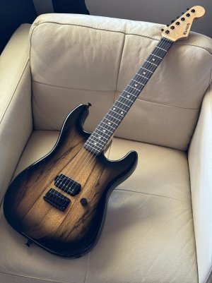

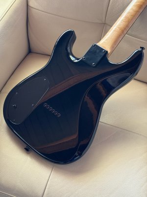

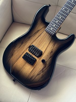

Finishing putting this together today. At one point had to send the body back to Warmoth for a refinish. Originally satin, now gloss. Looks incredible!
Body: 7/8 size Black Korina chambered with a Black to Clear Burst, contoured heel.
Neck: Warmoth Mustang/Jag Strat Neck - high gloss hand applied tru oil finish. (30 coats)
Pickup: Fishman Fluence Classic with 3 voices. Push pull knob switches between Voice 1 and 2,(PAF and Overwound/Hot Rod PAF) and a small dpdt switch on back cover activates Voice 3 single coil. Didn't want to drill in that beautiful top so I installed a tiny on/on switch in the back.
This is one of about 35 Warmoths I've either put together or have sitting around in a pile of parts ready to build.Warmoth78-a.jpgWarmoth78-b.jpgWarmoth78-c.jpg

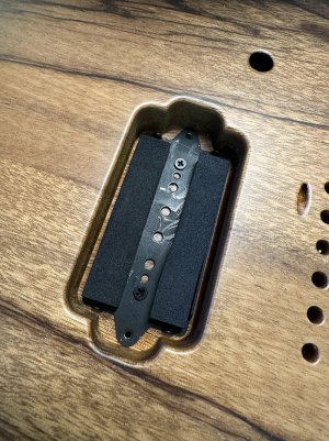

Also, for anyone interested on how I direct mounted this pickup, here's a pic. I screwed a humbucker baseplate to the bottom of the route and filed off a few millimeters from the top of the screw thread so I could leave the fishman mounting holes without drilling them out. Drilled a couple of small holes to accomodate the screws. Usually I order just a regular humbucker route and then you don't need that step.
That's sleek. But how did you pair the mustang neck with the 7/8 strat body? Did they custom rout the bridge and pickup for the 24" scale?
Beautiful!!!! I've been leaning towards another black Limba for a while now - how much does the completed guitar weigh?
Very nice ! I love the black burst going to the natural wood. Nice classy, clean look.
I've been wanting to do a black burst with Korina and having a hard time imagining what it would look like. This looks beautiful!
