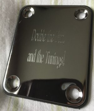

I went out and splashed on the custom neckplate,
Double the Fun
Edited to add, Oh, it's on the way!  :turtle:
