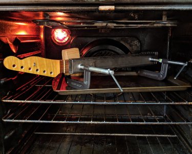

Now I'm confused.  The last time the neck was off, it had a definite backbow with the truss rod loose so I strung it up with 11s.  I took the neck off tonight and was planning to clamp and bake it this weekend.  Tonight, with the truss rod just snugged up from loose, under a straight edge I have maybe 0.002 clearance at the 7th fret.  I still think I need more clearance, but I'm surprised at that much change from just a few weeks of 11s on it.  I'm debating now whether to go ahead and bake it with a shim or wait.  I really need to get it playable with 9s.
Not for want of trying, but I've never had a neck change its curve by cold bending methods, no matter how drastic. But, stranger things have happened.
I think I'm still gonna bake it with 1 neck plate as a spacer.  I picked up a 16" piece of 1x2 11g rectangular tubing yesterday.
You can always pull out too much relief with the truss rod, so there's little to lose.
Trying it out...
Turned out exactly how I wanted it. Thanks Cagey.
