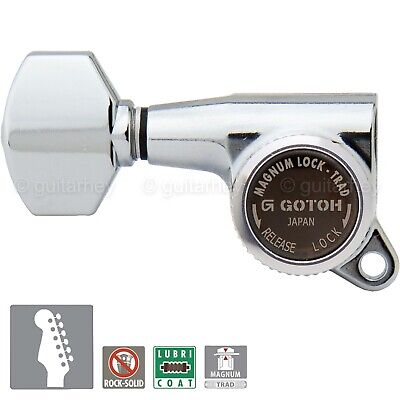

so issue #1........i'm a lefty, which made finding locking staggered lefty tuners a bit difficult. and then on the specs (for hipshots), it says they are compatible with 10mm holes, or 27/64" holes......which was really confusing to me. if the manufacturers (Hipshot, etc) are all basucally recommending 8.5mm or 10mm holes for the most correct fit, why on earth is warmoth using standard sizes that aren't even close or "on the money" for a correct fit. apparently you have to use a 25/64th hole and sand the hole a bit until the tuning pegs fit properly........which to me sounds ludicrous. why wouldn't warmoth just have 8.5mm and 10mm hole options under "tuning hole size"???? it's a drill press. can't they just change the bit to metric and make everyone happy??? why continue this mediocre support of metric and standard measurments on the exact same neck?!?!? so i enquired "are the manufactures producing these in metric or standard?". no-one could answer me. why should the solution to get a proper hole size be with a friggen #2 pencil and 220-grit paper, when they could just use the correct drill bits to begin with???
i went ahead and ordered the tuners b/c the diagrams did not indicate the size of the shaft that goes through the tuning hole?? so rather than just sit and wonder, i just ordered the tuners. new neck, new tuners, so i don't need to match old tuner holes. i'll measure the the tuners when they get here and make some kind of decision. or take someone's educated advice.
so the tuners are ordered and i'll deal with them when they arrive and see what the best option is for size.....perhaps i need a guitar "peg-hole-reamer?" no idea. maybe i can get warmoth to do a custom order on the holes. id prefer to get it sprayed with the clear satin-nitro finish inside the holes rather than bore them out and then have to re-seal the holes by reshooting the head-stock......
