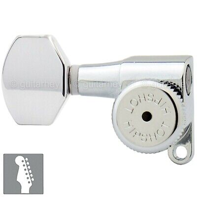

Not sure if you have a brand preference but I really like Hipshots. This site offers left handed locking sets: https://sporthitech.com/a/search?type=product&q=hipshot+left+hand
For Hipshot's I've always ordered the Schaller 25/64 tuner ream

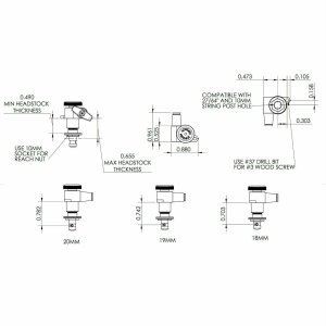

i'm wondering if those are the same ones i posted above from ebay.........if they are they have 3 size tuning pegs....2 of each. they say they are 10mm or 27/64......which is a bit weird.
are these the "schaller" tuners you were referring to? they don't specify what the post lengths are. i still don't know if i need 2 or 3 different sizes on a vintage/modern neck to avoid using string trees.

Any "staggered" tuners should keep you from having to use string trees; some brands just happen to use 2 heights, others like Hipshot use 3

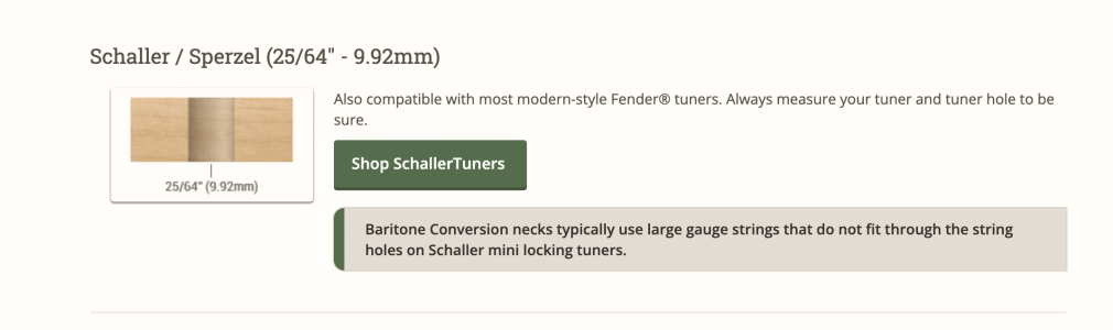

By "Schaller" I meant what Warmoth calls the "Schaller/Sperzel" tuner hole size
