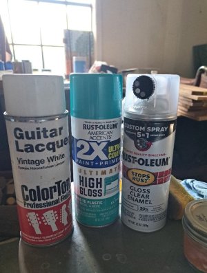

I did put 1 light coat of the clear, it's all on top of shellac, so the finish will wear uneven but the wood is well smothered... again... I have experience in what not to do... add this to the list
Are you using the Nitro with the Enamel Paint ? Probably not a good idea……
I have used that same rustoleum line and I dont believe its enamel. I use the same paint stick for all my projects and the nitro I sprayed on the neck after finishing a body using that paint has had no adverse symptoms after almost a year.
I am not endorsing without specifically testing it more but at a surface level, it seems that a nitro top coat over that particualr line of rustoleum paints is probably compatible.
It's enamel

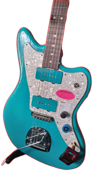

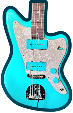

This one is wired and done except for knobs and switch tip. Used a .5shim in the neck pocket. Porter modern jazzmaster pickups wired 3way with volume and tone.
