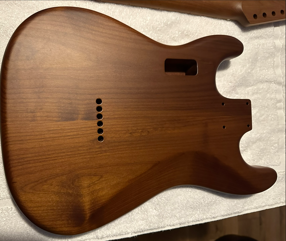

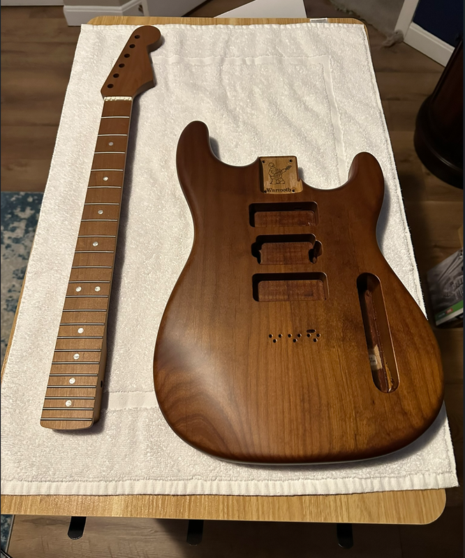

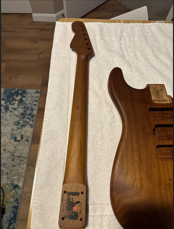

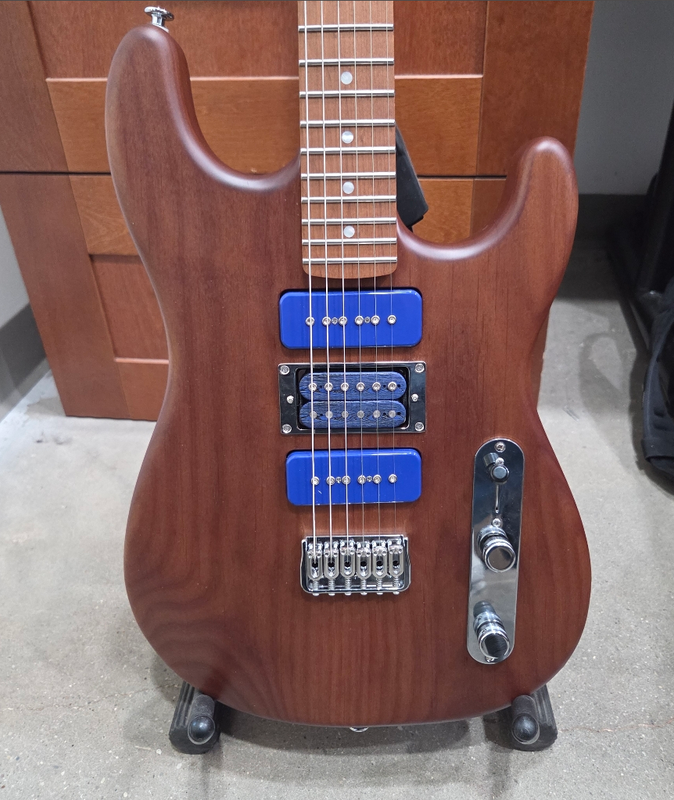

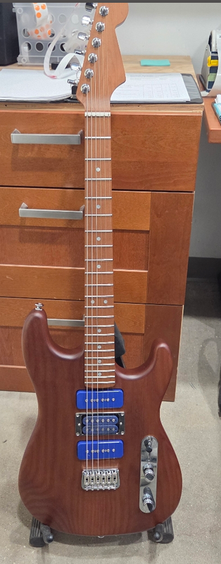

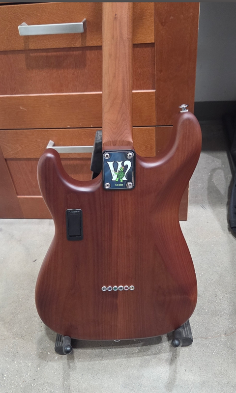

She should be home tomorrow! Here are some pics from the luthier.
I don't know if anyone makes a chrome neck plate pad, but I wish I’d thought of it with the chrome neck plate! Also, I was told they had to route the control area to fit the Free-Way switch. I'm not sure how I feel about the blue on the pickups, but it might grow on me. Planning on getting a chrome & blue switch blade knob.
