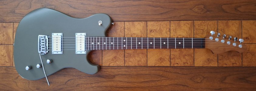

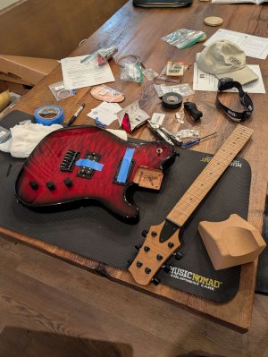

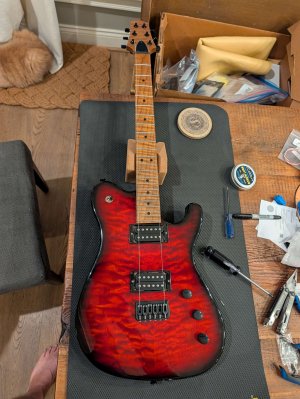

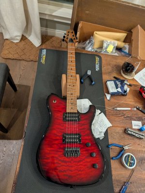

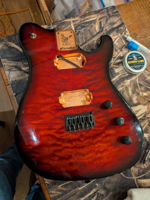

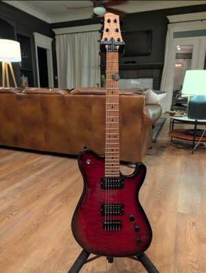

What a BEAST! I just finished up and few hours ago and its amazing. I am kind of dialing it in and setting up as i go and still have some fine tuning but I am loving it so far. im pretty sure i made a mistake wiring it up because the neck pickup has zero sustain and is much lower volume wise but ill figure that out in the near future. No way im showing a pic of my wiring job. lol. it was my first attempt and its ugly. :) Neck feels and plays really fast.. I am really digging it.
None of the imgur images are visible where I am. Any chance of posting them directly to the forum?
I've tried but the are too large to post. The only way I've been able to so far is with the imagr site. I would love to post them. Any suggestions on how? The guitar turned out incredible
Finished product is beautiful and plays incredibly. Need to figure out what I have going on with neck pickup (low volume and very little sustain) probably a bad solder connection and fine tune the set up. I can already tell this will be one of my favorites.
