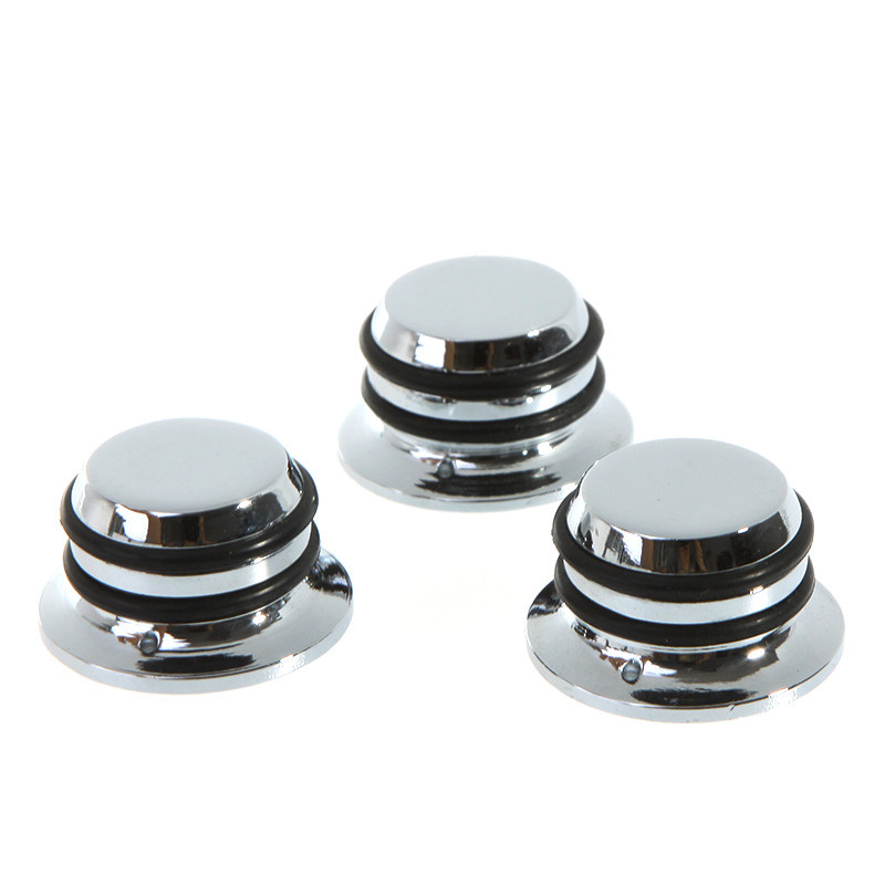

Wow!!!! That looks so gooood.  I hope you don't mind if I borrow your idea about chrome witch hats.  The knobs I'm looking at now are the white ones.  Following your build closely

Thank you. By all means take any ideas that will help you with your own build(s).

Thanks, Ian. One of those on the bottom of a clear plastic knob might do the trick.
I did order some of these to try. They might be the hot ticket if they're large enough to look right on there. If they don't do it, I'll attack those clear ones with some of that mirror paint. The specs show them at 1" across so it'll depend on how they look on.
