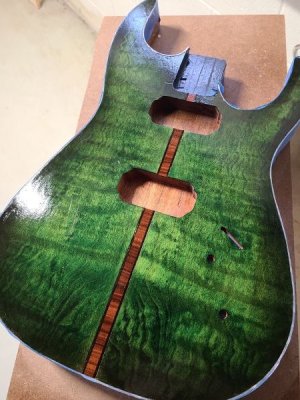

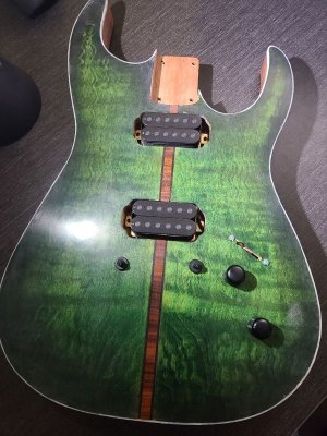

I don't remember if I posted about the body that I started almost a year and a half ago, but the baritone neck that I know I posted about recently is going on it. I started on it last March and as of December of '24, this is what it looks like:
Mahogany body, quilt maple veneer, white pearloid binding. The center line is a veneer strip that I put in place to hide a mishap with the quilt maple veneer halves. Green dye with black burst.

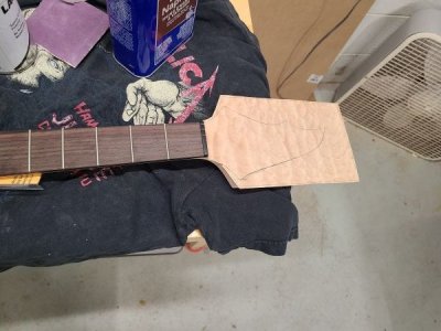

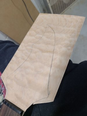

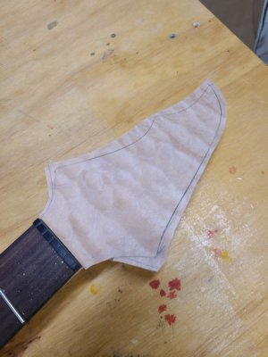

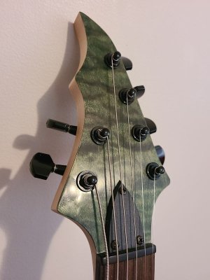

So this week I started on the neck. From a cut-off of the quilt maple veneer sheets, I applied a smaller piece onto the headstock and traced the template of the custom headstock shape I'd been working on that'll be a 2x4 config of tuners.

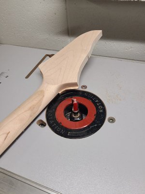

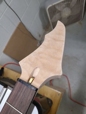

I used my handheld power jigsaw for the rough cut.
(those spots are old red dye, not blood)
And now the moment of no return. Do I make this a $400 mistake? Template is attached to the front face.

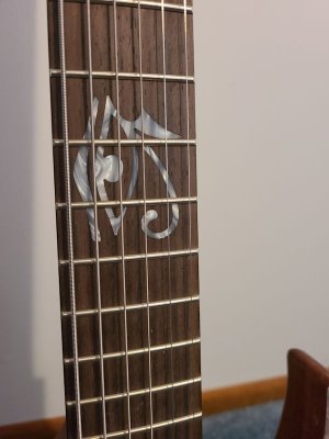

White pearloid Eye of Ra inlay @ 12th fret

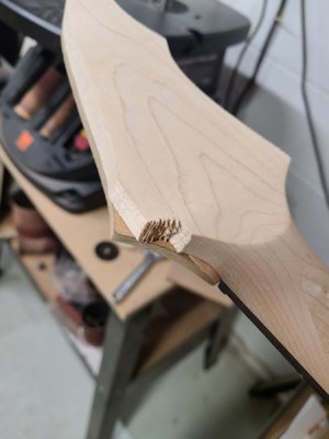

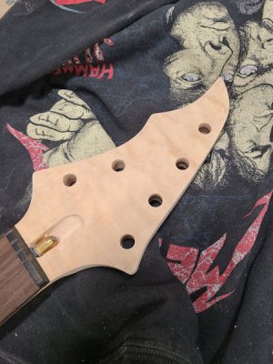

And sure enough, because of my daughter's separation anxiety, she's had to come down to the workshop every single time I'm downstairs. A fraction of a second of distraction and I got a bad tear out. :(
The impact broke off that one point, which, thankfully, I found. I also found a few slivers scattered around on the workbench and beyond, but there was no saving it. I had to walk away.
But later, I used Titebond to glue that missing point back on. Then I took it to my spindle sander to smooth out that divot. The final shape is off from the original design, but at least I didn't have to sacrifice a $400 neck.

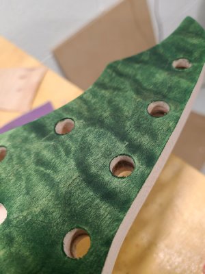

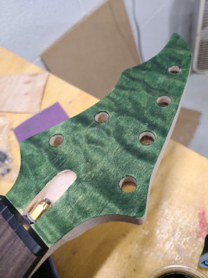

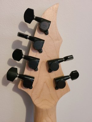

Then I drilled & reamed the tuner holes.
A test fit with the tuners.

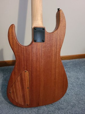

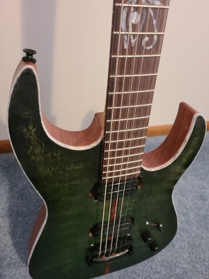

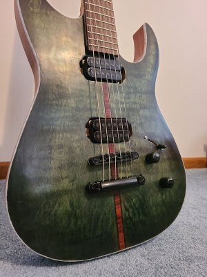

So my dumb self didn't measure the post spread before ordering the wrap-around bridge. The bridge I got is too wide, post-to-post, so I have to go back to the TOM/STP config, which means drilling the STP posts after all. But on the plus side, I got the electronics installed, the original push-pull coil-splits that I had on the project I pulled the pickups & pots from.
And now that I'm looking at this more, I'm going to need to replace those switch mounting screws with black ones.
I did receive the black switch tip this afternoon, after I'd taken this photo to show off to my coworkers.

I believe there is a Duesenberg wraptail that fits TOM posts, lemme see if I can dig it up
Edit: had it saved https://store.duesenberg.de/en/hardware-parts/31/duesenberg-wrap-around-bridge-74mm-spacing

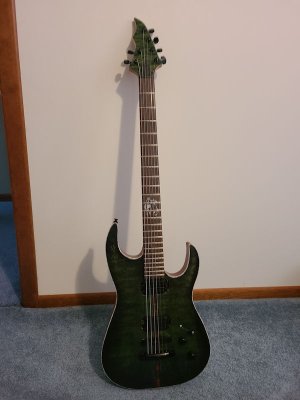

Couple of flaws that have been stuck in my teeth for quite a while but was too far along to scrap it and start over. As with all builds, I learned several things through this project. Keep on keepin' on. In the meantime, I have a new baritone guitar with dual coil-splitting. :)
