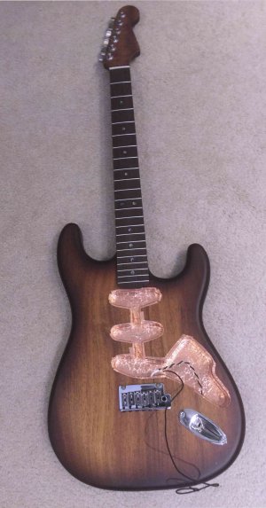

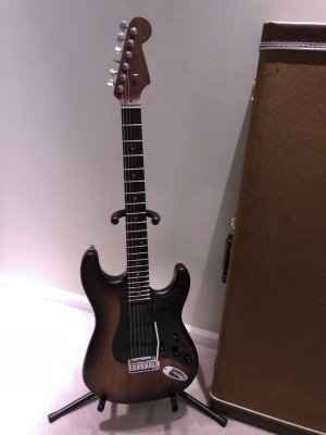

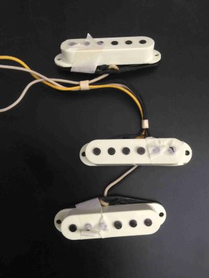

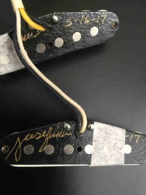

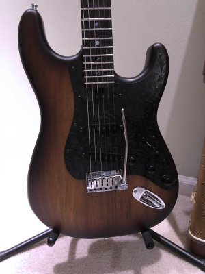

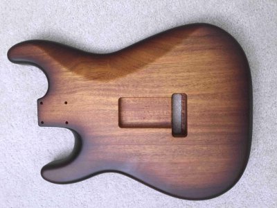

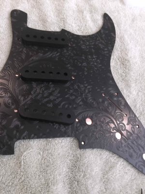

I Stumbled upon some Fender Custom Shop Josefina Ancho Poblano Pickups and decided to put them in this project. The Pickguard is custom Bakelite Floral Paisley with Backplate. Black Round Top Knobs, Fender Deluxe Tremolo and Locking Tuners.

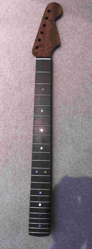

Neck
Style: Stratocaster®
Construction: Vintage/Modern Construction
Orientation: Right Handed
Neck Wood: Mahogany
Fingerboard Wood: Indian Rosewood
Nut Width: 1-11/16"
Back Shape: Standard Thin
Fret Size: SS6150 (Stainless)
Tuner Ream: Schaller (25/64")
Radius: 10-16" Compound
Scale: 25-1/2"
Fret #: 22
Pre-Cut Installed String Nut: GraphTech White TUSQ XL - Standard Nut
Inlays: Abalone Face Dots
Side Dots: White Side Dots
Finish: Vintage Tint Satin Nitro

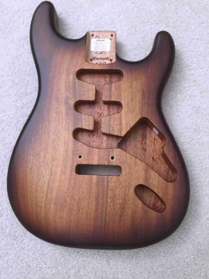

Body
Model: Stratocaster®
Scale: 25-1/2"
Wood: Mahogany
Rout: Top Rout
Pickup Rout: Strat®, Strat®, Strat®
Controls: Volume, Tone, Blender w/5 Way Switch
Bridge: American Standard Strat® Tremolo
Stud Install: Use inserts from bridge on order
Jack Rout: Strat® Top Jack Rout
Neck Pocket: Strat® Shape
Contours: Contoured Heel / Tummy Cut / Forearm Contour
Top Finish: Tobacco Burst
Back Finish: Tobacco Burst
Finish Type: Satin Finish
Neck
Neck Wood: Mahogany
Nut Width: 1-11/16"
Scale: 25-1/2"
Fret #: 22
Body
Scale: 25-1/2"
Wood: Mahogany
Rout: Top Rout
