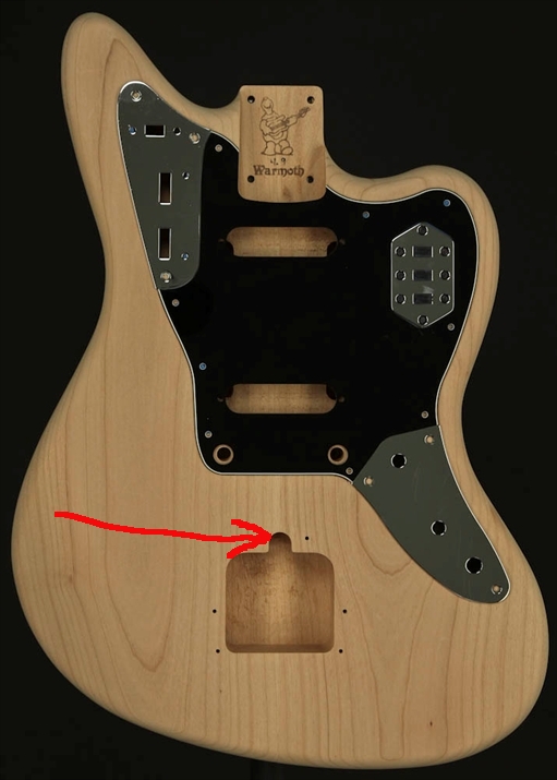

I see you used a "Fender" vibrato unit. I know exactly where it's rubbing internally. I had the same problem with Tipperman's Jag. The problem is the little nub they carve out to relieve for the trem lock button...
Warmoth sells that unit without the lock (probably because it's worse than useless), so they don't have the problem. They also drill the mounting screw holes for you, so you can't easily adjust position. So, if you use the Fender part, you'll have to route that little nub out a little farther in the direction of the bridge. For as small a job as that seems to be, it's no fun, lemme tell you. You'll have to use a free-running mortise bit (unless you have a template), so the chances of the router getting away from you are higher than usual.
If you undertake to fix the problem, be sure to test the action of the vibrato unit before restringing. My memory isn't good enough to say whether I had to route along that forward wall as well. If I did, it was probably only a sixteenth or so. In any event, better now than later once you've got the thing back apart. If you're not comfortable playing with a router (or don't have one), I'd recommend just buying Warmoth's version of the unit. You can always put the Fender part on eBay.
Ah, not so dramatic, I expect.  I had a similar problem with the AVRI unit on the bass VI, and just a little dremel/drum sanding where it rubbed on the wood, and it's smooth as glass now.
