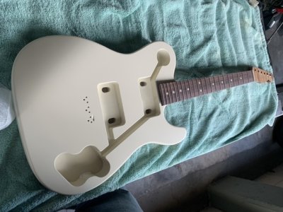

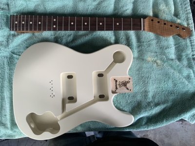

Just received my guitar parts from Warmoth about a month earlier than expected.
I’ll take pictures and post some here if I can figure out how. Below is the parts list I may decide to change the black pick guard out with a tortoise on, should be easy on this type guitar.

🎉 all these early shipments are giving me hope!
Please post pics of your build, this should be quite pretty. Vintage white is a favorite Tele color for me.
I'll (hopefully!) be right behind you with my first build as well.
All parts are "in house" except the Warmoth body, neck and pick guard.
Good luck!!!

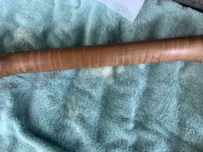

That neck looks niiiiiiiice. I'd like to see its backside. 🧐
I should have provided that picture also but I forgot to take it. The neck looks really good without a finish the flame is noticeable and kinda catches the light. I’ll get a backside picture soon.

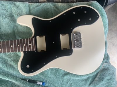

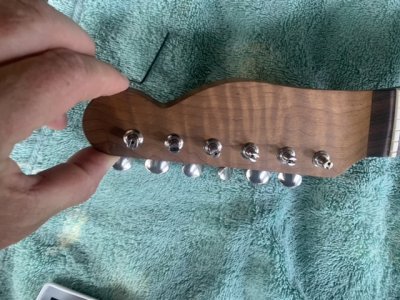

Progress report installed tuners, installed bridge and measured scale length and took some photos.

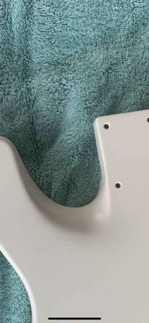

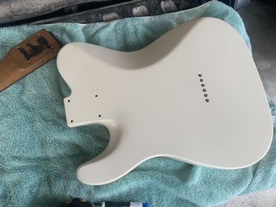

On this tele body the single cut has more wood taken out on the backside, is this something Warmoth does on all tele bodies or is it because of custom contoured heel?
If you are referring to the "tummy cut", that is a separate option. Available with or without the contoured heel.
I’m referring to the contour inside the lower horn
