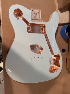

The body showed up on Saturday. I checked the fit of the neck and it's perfectly snug in the pocket. I put some copper foil in. Not the best job, but also not bad for my first time.
While I was looking into installing the cup, I learned the hard lesson about Tele jack inputs. I decided to skip that. I have an electrosocket coming, but I was wondering if there is a plate that fits the 7/8s cut?
Most plates (square/football), footballs are cutting it close but the ones sold by Warmoth will cover just fine.The body showed up on Saturday. I checked the fit of the neck and it's perfectly snug in the pocket. I put some copper foil in. Not the best job, but also not bad for my first time.

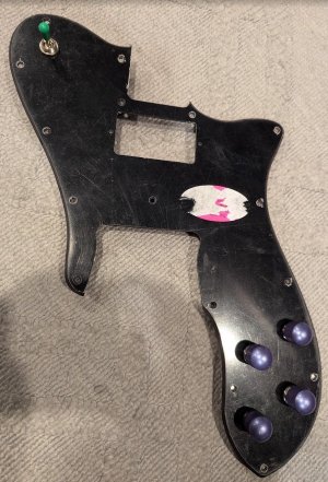

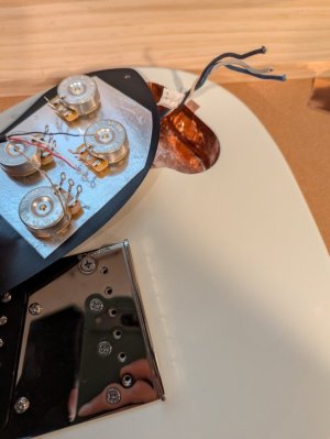

before anything else, check with the manufacturers of each pickup, to verify their "wire color codes"...I'm setting myself up for soldering and I'm realizing I am doing something that isn't easy to find an answer for in tutorials.
I've got a neck humbucker with 4 wires: red, black, white and braided. I've got a P90 bridge pickup with black, white and blue wires. I've got 3 ft of black/white wires. A three-way switch, a mono input jack, a tone and volume knob for each pickup, a cap for each tone knob and a treble bleed for each pickup circuit to experiment with.
Attached is a picture of the pots and wires for verifcation.
Curious where I can find the right schematics for this?

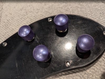

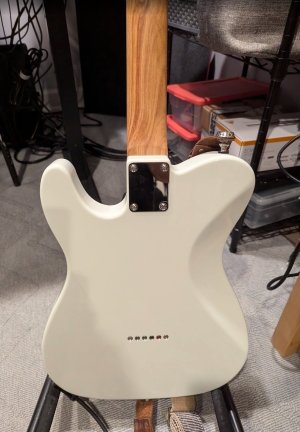

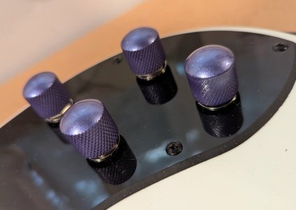

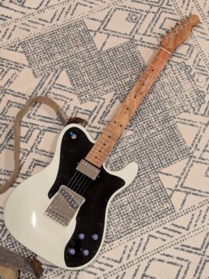

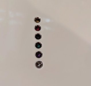

I was scouring the internet for colored knobs and came across this guy on eBay: https://www.ebay.com/str/arsilverguitarsThats a really nice combination. Can you post a pic of the back? And where did you get those purple knobs?
