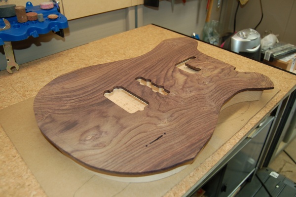

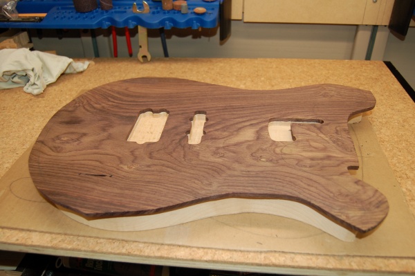

I transfered all the routes from the body blank to that so it should allow me to drill with enough precision the holes to get the router started. The only issue is that the router bit that I have is a bit too large diameter for the corners of the J-pickup so I will have to square those up a bit with a small sanding drum in my Dremel. The template also has the positions for the bridge holes so it should be pretty straightforward to drill those as well. I expect the really delicate part to be thinning the top where the 5-position swich is going.

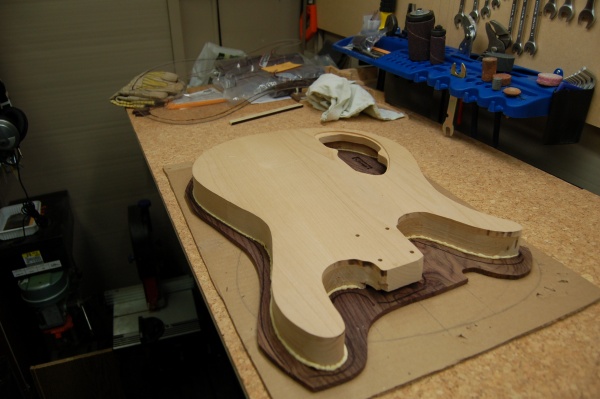

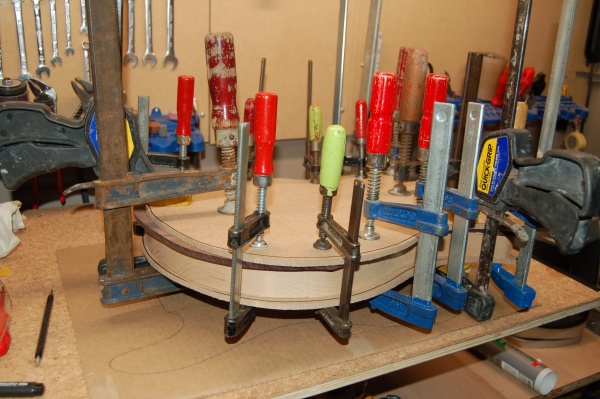

Glueing the top to the bottom, everything clamped down:

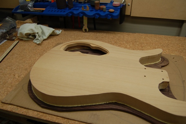

The complete body, just needs the top to be routed to the contour of the bottom, shaping of the area around the horns, and cutting of the f-hole. Well, it's not really an f-hole. You'll see.
