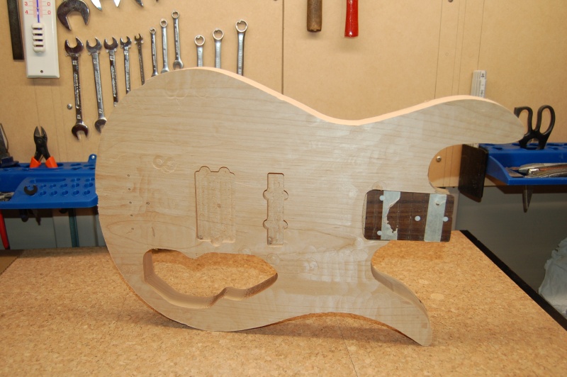

First of all I warmed up my router by making a replacement rear cover from a piece of Ebony. On a J-bass the cover is too big to cut a replacement from one of those pieces of peghead veneer that Stew Mac sell, but on the body blank the rear cavity is smaller, I think it's a P-bass shape rout, and the piece of Ebony was just big enough. I actually spent more time fabricating distance pieces so the guide bearing and the bit would be at the correct height, than actually routing. Definitely one to add to the list of 'piece of cake with major effect'.
Next up was the template for the body. I've copied the major body features to a sheet of Perspex, and then drawn my idea of a body outline. It's roughly based on a J-bass, with the upper horn drawn a bit forward, the rear more rounded like an LP, and the lower horn turned down in the style of my Traben Torrent. I've started shaping the template using a belt sander but it's a b1tch... perspex powder is static as anything...
Next will be transfering the design to two wood panels that will serve as the actual routing templates, one for the body cavity and one for the exterior outline.

OK, time for another update... The body blank has had 8mm removed from the top and the outside contour has been routed. I'm going to have to do some corrective sanding because at one point the guide bearing slipped under the template and at another the template itself moved. Fortunately not irrecoverable. Previewing the post I suddenly feel compelled to add that I'm NOT building an upside-down JEM. Wonder why that suddenly popped up in my mind. Oh yeah, and I'm also not building a sitar. There will be a normal neck. I just used a bit of an old fretboard as a routing template for that bit because it was lying around.
Next will be routing the body cavities, then I'll be stuck until the top arrives. That is proving a bit taxing. I placed the order at Exotic Woods and got an automated confirmation but nothing else. I mailed them to ask for a status and got back a non-delivery report stating that the IP of the sending mailserver is listed on some anti-spam list. That's the mailserver of the third largest ISP in Belgium. Wow. So I put the same request in the contact form on their website and got an automated confirmation message. Again, that's all I got, but in the meantime the specific top which I bought can't be added to a shopping cart anymore, so maybe they're very discreetly processing the order anyway. Grrr....
