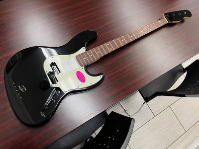

At this point I thought: if I pair this neck with a Warmoth J body and routed with the Warmoth "correct P position" J pickguard, then add some Res-O-Lites, I will have a 64-65 flavored "unit" instead of a bunch of random bargain parts.
I really liked the Greasebucket in the Fender, so I thought I'd add that in. But what about the extra hole I'm going to have in the control plate? HOW ABOUT A WUNKAY circuit with passive bass and treble cuts? That's in the works, along with a crazy and unexpected surprise from Sweetwater & G&L which I'll go into later. I made pals with a real electronics wizard at work who agreed to help with the schemer and soldering (mine is terrible). There are a few Wunkay circuits circulating on the web, but they're all kinda hard to read, so, hopefully I'll be able to clear that up also.

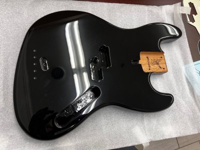

For extra "Wunkay" cred, I ordered this J body in Mahogany and killer gloss black. Check out the dummy-up pic: the neck is sitting down in the pocket WITHOUT any screws. TIGHT!
I have everything I need EXCEPT a Gotoh 203-B, which are slightly "unobtainium" at the moment. DARN!! Plan is to do .110" Labella Deep Talkin' flats...the steel rods will handle them, no problem there. Another plan is to get a Spitfire 60's speckled burgundy, but the Warmoth mint is really crushing it at the moment!

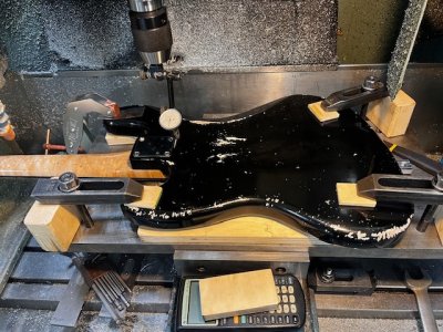

I finished crashing my way thru re-tooling my neck plate procedure. All of my programs and fixtures had to be re-done. I think 6X #10 screws (a la Music Man, G&L, etc) will work just fine.

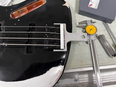

I got a chance to try my “Kitty Litter Scooper” and boy did it pay off! This device now tells me exactly where the center of the bridge is *while* the body is flipped. Trying anything on the backside of a bass has been a total crapshoot until now.
I have a new process for milling thru paint - my favorite thing! (not) and it is working sensationally. Run the sharp chamfer tool FIRST, then run the endmill second so it “finds” the unpainted edge. Touchup with black Sharpie. (works great on black basses…sorry for folks working with other colors)
Note: progress pics are not of “Pwunk Jazz,” but another super famous Warmoth tribute build which I’ll go into soon (some eagle eyes might get it???).
