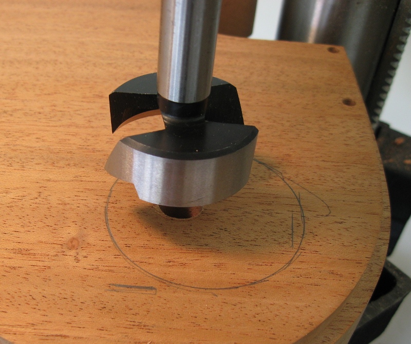

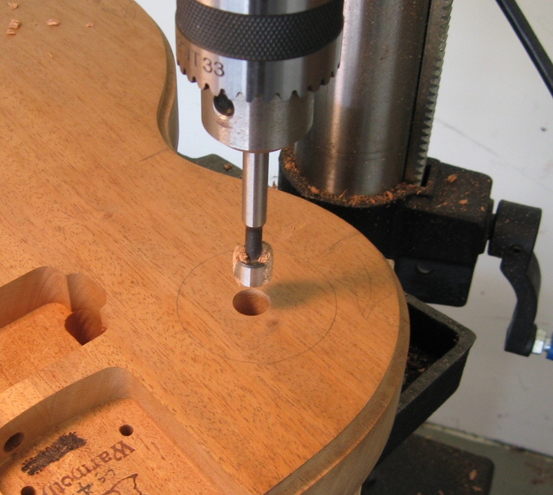

First, I needed switch cavity and a way to mark the center on both sides of the guitar, as the hole(s) would be drilled that way to protect the outer surface. Easy enough. Just drill the small switch mounting hole first, as it has to go all the way through, and that will automatically give me the center on the back. So, we chuck a 1/2" Forstner bit into the Drill Press of Doom, clamp Mr. L5S to the stage, and commence to drillin'.
And here we have it. Nice and clean. Gotta love Forstner bits. Incidentally, you can't see it, but there's an Oak backup board under the body so I didn't try to drill the stage with a bit made for wood.

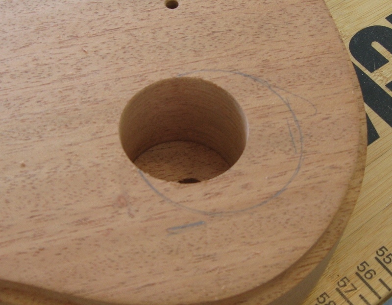

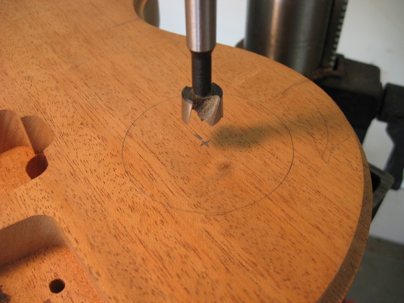

Now that we have a hole in the right place, we flip the body over to make a control cavity. Pay no attention to the pencil marks; they're an artifact of a nasty brain fart. Chucked a larger Forstner in - 1 5/8" this time - and get it located. It's not real obvious in this shot, but the cavity hole is going to be a somewhat off-center from the switch mount hole to allow for wiring clearance once the switch gets mounted.
And once again the Forstner pulls its load...

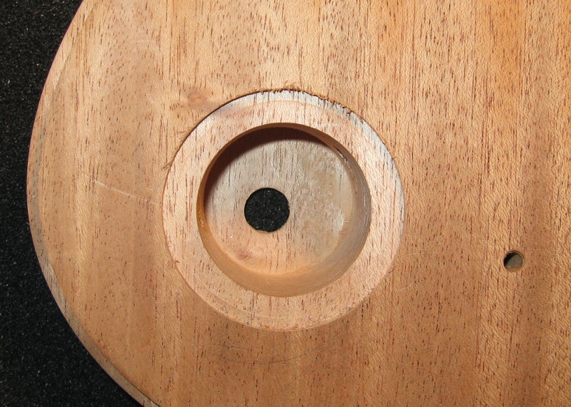

Then, of course we need to relieve the edge of the hole so the cover can be flush-mounted. That had to be done by hand with Mean ol' Mr. Router and the Dado Bit of Despair. Didn't take any interim pictures, but here's the result...
With the switch in place, you can see where a bit of offset for that mounting hole will come in handy. There are going to be three 1/8" thick outer-braid shielded wires soldered to those terminals, and they're not going to want to bend around much. You can also see the hole I had to drill to run those wires through. To drill that, I used a 12" long  5/16" diameter aircraft bit, and came in from the pickup cavity side.

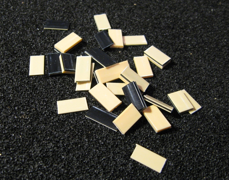

So, that stack of binding I originally made looks like waste. But, I did find a use for some of it after all.

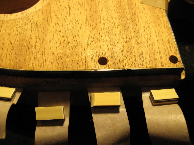

When you want to make a thicker multi-layer binding, you need a deep channel. If you want to do it one layer at a time, no matter what thickness you start with you're going to have trouble holding it tight against the body while you tape it in place and wait for the glue to set. The tape is going to be pushing at an angle, while the force you want to apply needs to be perpendicular to the attached/glued side.
So, I got out a PVC tube cutting tool, and started making a pile of little 1/4" to 1/2" spacer blocks out of the previously built-up binding. As you can see, many pieces separated at the lamination, but that was ok. As things progressed and the installed binding layers stacked up, the spacer blocks would need to get thinner anyway...

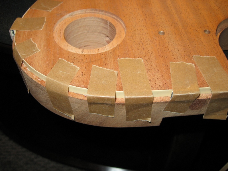

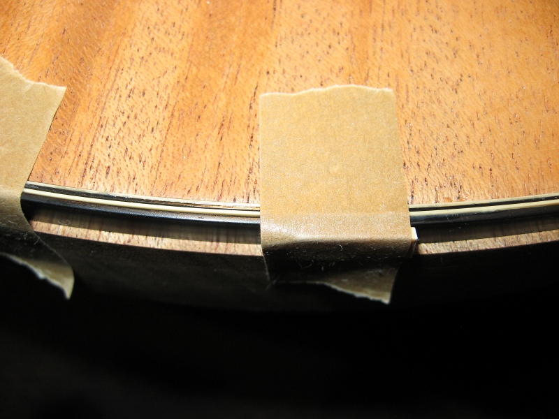

Next step is actually glueing on the first strip. For this stage, I used something called "Weld-On #16", which is basically a combination of really nice solvents like Methyl Ethyl Ketone and Methylene Chloride mixed with some acrylic monomers to form a goop similar to Testor's Model Cement, for those of you who used to build plastic models as a kid. No Toluene, though, so you can't get high off it; you can only get cancer. At least, that's what California thinks, so try to avoid injecting 50cc of it directly into your bloodstream every 15 minutes for 10 days like they do to lab rats to prove that it's toxic.
Basically, it melts things together, but the acrylics give it some body and strength once it re-hardens to provide a good grip on something porous and non-melty, like wood.

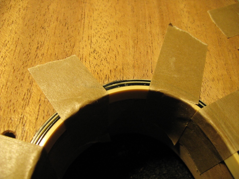

So, you squeeze out a thin line of the stuff and kinda smear it around so the channel back is coated. Don't go too thick - you don't really want to squeeze much of this stuff out when you press the binding into place, or it'll melt the top of the binding strip as well as the surface you're trying to attach to the body. Only do 4 or 5 inches at a time - the reactions are pretty fast. Press the binding in place, and tape it to hold.

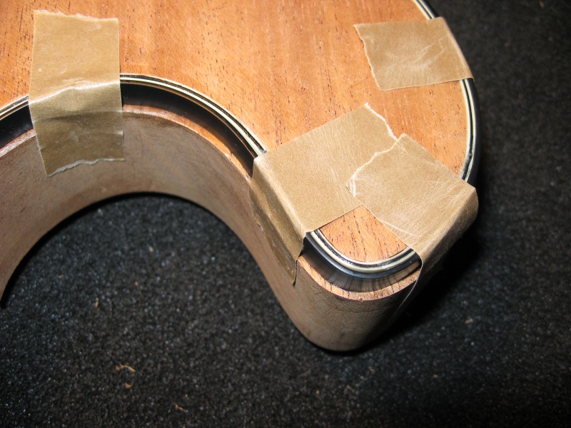

That's a high-tack tape commonly used for this purpose. Wicked sticky, but leaves no residue.  You can sorta see where I've used the spacer blocks to apply force more evenly.

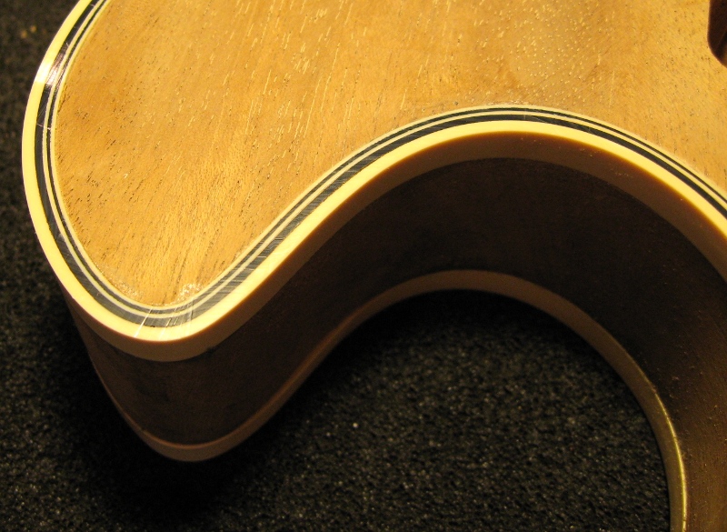

Once you've given the stuff time to do its work (they recommend 24 hours, but I cheated a bit here and there), you can peel back the tape and do the next strip. For the subsequent binding strips, I didn't use the Weld-On goop, I painted on straight acetone with an artist's brush. Here are a few shots after successive layers of binding...
Yeah, it's an oogy mess. But, fear not! We routed the depth of the binding channel a tad shallow so we could scrape the top of the sandwich down level with the body surface. All that molten plastic slop and strip edge variation goes away after scraping in later steps, so it looks like this...
Scraping is done with a machined and burred piece of spring steel. I won't bore you with the details; you can read about them here.

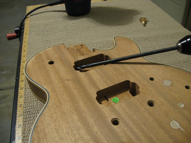

Somehow, I managed to miss the switch access hole drilling shot earlier, so here's a setup shot that illustrates how that works...
You can see that without the very long bit, the drill motor's chuck and body would be too close to the guitar body and the hole would have a much steeper angle to it. With the aircraft bit, you can lay it down better. There's another hole you can barely see leading in from the neck pocket that goes through the neck pickup cavity and ends up in the main control cavity, and I drilled a third one leading from the bridge pickup cavity to the neck pickup cavity. This will allow for simpler wiring, where the pickups go directly to the switch, then a single line will run from the switch to the main control cavity. Very clean, with no splices necessary.
You can also see where I plugged the stop tailpiece mounting stud holes, the original pickup switch hole, and three of the four pot holes. I then added a pot hole in a more accessible spot just below the bridge pickup. So, even though it's supposed to be an L5S, we'll have the pickup switch up top and a single volume and tone control in the lower rear. A 7/8" hole for the output jack is on the side.
