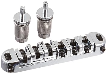

I was looking at the B7 to start with, too. But, the B5 is more appropriate. I'd still have bridge problems, though. I'd need something with saddle height adjustment, as I'm going to have a compound radius neck so I need to get flatter (~18" radius) than most bridges without adjustment (~12"-14") go. Plus, I'd want roller saddles on any bridge mated with a Bigsby, which precludes re-cutting saddles to get the radius I want.

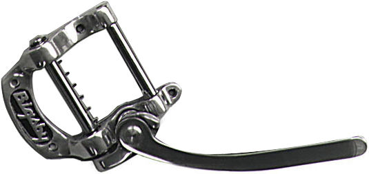

Speaking of vibratos, Pelagard suggested a Bigsby for this one earlier in the thread and I'd discounted the idea out of hand, but the more I think about it the more I think I'm going to do that. It'd just be way too sexy, which is just the right amount. If it doesn't stay in tune, then I'll just bitch about it <grin>

Are you sure you're not confusing a Bigsby with a Floyd Rose? This is the unit I'm talking about...
Of course, I'm not going to use a Tele bridge. I'm going to use a Wilkinson roller bridge...

Bigsby's are not that hard to restring, when done properly.
Either take one string at a time. Or for a full resting - look at Youtube for instructions.

Yup, I do indeed mean the Bigsby...just wait and see...
I'm sorry, I'm just not seeing where the difficulty is. It's basically a wrap-around bridge string threading operation, but you have to thread under a roller to get to the actual bridge. Am I missing something?
I used to have a very similar unit on an Epiphone ES335 copy about 100 years ago, looked very much like this...
...but it wasn't a Gibson. I was just a grasshopper back then, so I didn't change strings often. But, I don't remember it being any kind of difficult.
How much instruction does one need?
I'm getting the idea that I've forgotten something. I remember the thing didn't stay in tune worth a tinker's damn, but that's a design issue that a roller bridge, slippery nut and locking tuners should mitigate to a large degree. Nothing you can do about using a single compression spring to return to neutral, so you just make sure that's the only variable in the chain.
There are different Bigsbys that look the same but aren't... for instance, the B5 vs. B50 vs. B500 has to do with what they're made out of and what kind of pivots are used. The original B5 is sand cast vs. die cast and uses ball bearing pivots vs. bushings. It's also dramatically more expensive. But, if you use that one vs. the others, it's a much more predictable part, even though it's still not a good design.
