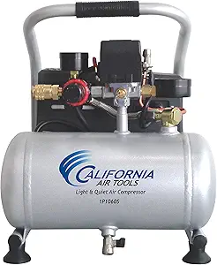

and I think he's probably right  - a guitar body is probably on the upper end of air brush area/volume, and what he says about not buying anything without a tank rings true with what I know. For the same money you can get a quiet small tank compressor like this one, and the tank will be at a much higher pressure than the "air brush compressor" so it'll last longer before kicking in. And it'll be enough to run other small tools (brad nailers, and the ever handy "blowing crap off". (I once read someone's amusing screed where he talked about the weeks he spent researching compressors, two stage, CFM @ pressure, maintenance, noise, etc... and bought a big two stage 80gal tank, only to find that "99% of what I use it for is blowing crap off things.")

This compressor has  a vastly higher CFM than the 1gal one I posted above - while still being small quiet and cheap.  Also the 2 gal tank will provide a bit more buffer.
https://www.harborfreight.com/2-gallon-135-psi-ultra-quiet-hand-carry-jobsite-air-compressor-64596.html

A lot of guys seem to think a guitar is a car when it comes to CFM. I've been waffling back and forth between the quiet 2 gal 2cfm @ 90psi deal and the same priced loud 6gal (@175 psi - so it's closer to 8 gal @ 135) 3cfm @ 90 psi compressor. The other consideration is that that slighter bigger compressor is pulling 12A which will basically consume a whole circuit, and my shed & garage are both limited on power.
The other air hog I have occasional need of is seating beads on tires, but they sell what's basically a small air tank with a big dump valve on it for that. Speaking of which - the little 1 gal compressor is on sale right now for $109 - 0.7cfm@90 psi or about 2 cfm @ 30 psi. I figured that 1 gal would last 1.5 minutes at 3 cfm/30psi, but you can buy an 11 gal tank for $40 and now it's good for 18 minutes @ 3 cfm.  I can't believe this but I'm actually thinking about getting the small 1gal job. Partly because I think it's barely enough, and partly because I'm probably asking for this as a birthday present.

I think I've about reached my decision - going with that 2gal $160 2cfm@90 psi compressor. The $100 1gal / 0.7cfm @ 90 psi can supply about 2cfm at 30psi - which I think is barely enough to run a 3cfm spray gun for long enough to get a pass in, then catch up.  It's bumping the limits of barely enough. The 2 gal 2cfm@90psi can supply more than enough for a small spray gun, isn't much bigger, still fits on a circuit with other tools, and is enough to run various other small shop tools, and with some supplemental storage can do about anything I'll ever need.
