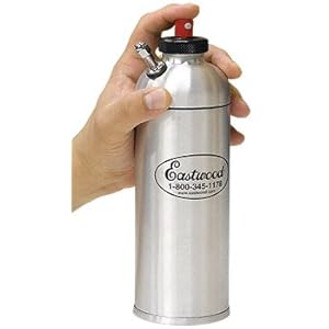

Another nice thing about having a compressor in the garage is you can do other things besides paint with it. You can keep tires inflated, run an impact wrench so you can rotate them easily, and a lot of other tools you can hook up as well. Get a little refillable compressed air can like this...
...so you can spray cleaners, insecticide, paint, etc. or even just compressed air for use as a duster in your computers or other stuff you can't really wipe. Compressed air is a handy thing to have around.
