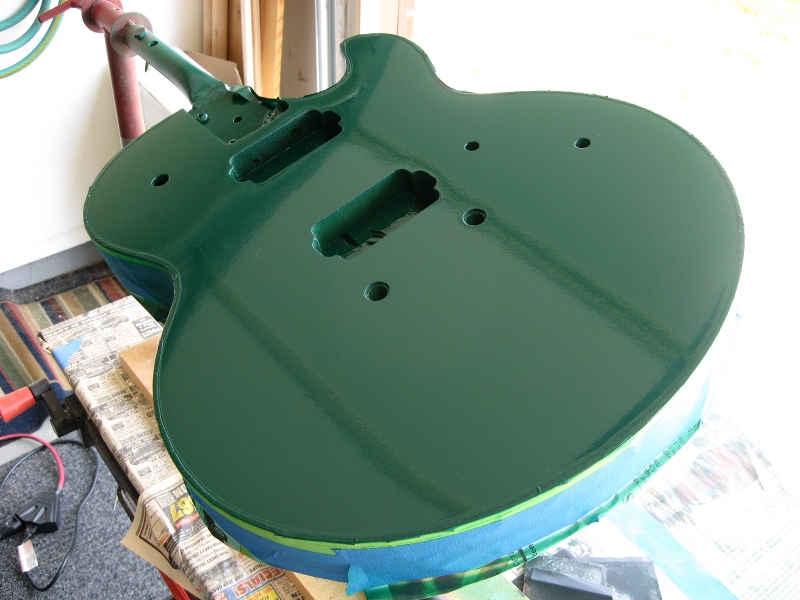

Well it's been a while but I've been working on this project some and seem to have hit a roadblock...
I was able to fix the cracks I mentioned earlier by wicking retarder into them. I drop-filled any depressions, and then sprayed four more coats of lacquer. Then I waited a while, and recently I've been re-doing the sanding this time using mineral spirits instead of water.
I was able to get a good shiny gloss this time, but unfortunately there are a ton of tiny scratches on the surface too. I switched the direction of sanding with each grit, and there are scratches present from each stage. Which means I added scratches with each sandpaper grit. I'm really frustrated!!!!!
Here's a photo, the white bar is the light above my workbench:
My process was, after spraying, sand with 1000/1500/2000 wet/dry paper using mineral spirits. Then I used the 3 micron and 2 micron versions of this paper:
https://www.stewmac.com/Materials_and_Supplies/Sanding_and_Polishing/Sandpaper_and_Finishing_Papers/3M_Flexible_Polishing_Papers.html
Last I hand-polished using the Stew-Mac medium compound.
I was really careful about cross-contamination! (or at least I thought I was) but I suspect I got some grit/contamination in between the sandpapers and the lacquer. So I'm curious what you guys do to avoid this?

Those are deep scratches, likely there from much earlier in the sanding process. As you get finer with the abrasives, the scratches they're able to remove must be progressively finer as well, or they go essentially untouched. It's difficult to say how far at this point and I know it seems counterintuitive, but you need to go backwards a bit to coarser papers. Perhaps a coat or threee of clear, leveling between coats with 320, then gradually going through the finish sanding process again with the progressively finer grits until you're ready for buff/polish.
I know it's a pain in the shorts, but at this stage of the game you gotta do it.
Something else you may want to get is some "tack cloth". When you finish a sanding step, wipe it down good with naptha and let that flash off, then just before sanding again wipe it down with the tack cloth to be sure ALL contaminatioin is off the surface. Somehow, wherever you're working is a allowing for a lotta particulate matter to settle on the surface and your subsequent sanding is just grinding it in.
Also, when sanding, don't be afraid to change papers to fresh perhaps more frequently. Sandpaper is cheap in the grand scheme of things. After all that work, you don't want that stuff loading up and marking your surface.

Man, finishing is really hard!!! Not to sound like a whiner, but I'm finding this much more difficult to master than a lot of other instrument-building tasks. I'm shocked at the level of meticulousness that's needed.
Anyway, they're deep scratches, but I don't think they were necessarily from early in the process. They are in the direction that I sanded with the coarser papers, but also the final papers so I think whatever contamination happened was present throughout the process.
That being said, two things you mentioned really stand out to me:
-I didn't really clean the body between sanding grits. I just did a cursory wipe-down to remove the "sawdust" but it sounds like I really need to clean everything carefully with naptha. I do have some tack cloth that I used between coats of finish so I'll use that here too.
-I didn't switch to new sandpaper soon enough, I remember it got really loaded but I thought it would be fine. Lesson learned.
I think a 3rd issue is that the body might be picking up sanding grit from previous stages on the workbench. I have some kitchen drawer liner material for the body to sit on, but I didn't clean that between stages (and it would be pretty hard to clean). Just wondering what you do - what sort of non-marring surface do you put the body on for sanding? Is it something that can be cleaned easily?
After the last spraying as the body cured I did also get some new, pretty wide cracks in the top (not on the back though, how annoying). So my plan is to drop-fill them and then spray a few coats of lacquer on the whole body. I know the cracks may be unavoidable as they could be from soft shellac underneath (like I mentioned earlier) but I think it's worth a try.If nothing else, I'm learning a lot about finishing through this process...
