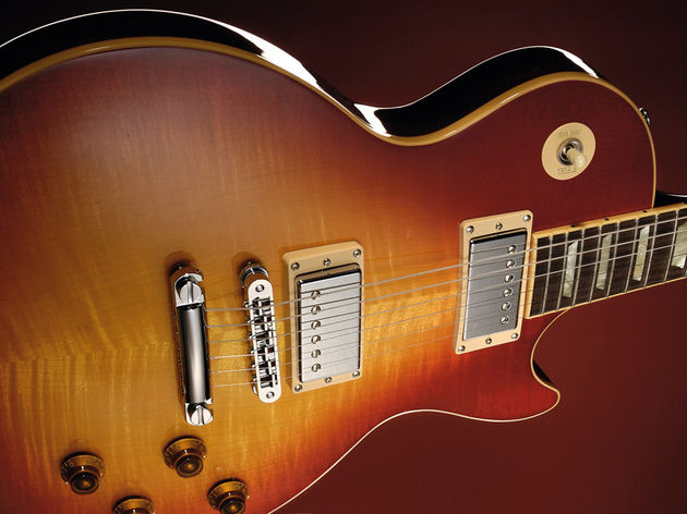

You didn't happen to wrap the strings around the tailpiece, did you? I've seen that done before, and it'll reduce the breakover at the bridge dramatically. They're supposed to feed from the rear of the tailpiece and come out the front, heading for the bridge as per so...
Usually, the angle at the saddles is severe enough that you wonder why the strings don't break at the saddle more often than they do.
As for the bridge being too low, a quick fix is to just loosen the strings enough to pop the neck off and put a shim at the body end of the neck pocket. Doesn't need to be much - about the thickness of a medium pick (1mm or so) is usually good. Tighten the neck back on and that'll put an angle on the neck that moves the headstock back and will lower your action enough that you'll probably want to raise the bridge.
