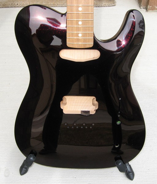

One thing to bear in mind if having a body over routed from the showcase is as  follows.
When the traditional Tele pickup route is modified to a humbucker route, you end up with just a small bit that doesn't get cut. You can see it in this pic on the bridge side of the cavity...
That little bit that doesn't get cut is just barely visible once you put a mounting ring on there. If you hard-mount the pickup to the body without a ring, the flaw is obvious. I think on that guitar, I had Doug make me a custom ring with slightly deeper frame sides, so you can't see it at all.
Also, that neck pickup cavity was recut from a tradional Tele neck pickup to accommodate a Strat pickup, and you can see it's wider than both the original cavities as well as the humbucker cavity.
In terms of an over routed bridge humbucker part of what was the Tele Bridge will not be totally hidden by a pickup ring. Using the Gotoh Humbucker Tele bridge would cover it.
Over rout of Neck pickup...humbucker ring would cover things.
