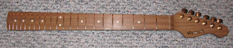

Cagey, could you please post or link a picture of your Afra neck headstock?
This is as good as I could find...
Here's a shot of it installed on the body...

Thanks a lot. extremely helpful... I can say I wouldn't mind Afra. then yours is a wonderful one.
