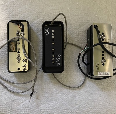

-Single P90 in the bridge position. I like the sound of neck pickups for certain things, but I always end up bashing into them with my pick. So rather than doing something silly like improving my technique, I plan to get different "pickup tones" with my switching. I'm not much of a tone knob twiddler, so I wanted the benefits of twiddling while getting repeatable tone values every single time.
-The switching will consist of one of two options:
One volume pot, which is a given.
Option 1 - 3-way Blade Switch wired to give different flavors to the pickup. Basically used as a single pole switch. Each position is followed by a cap (of a particular value) mated to a resistor (particular value). This works like a tone pot set at a certain position with a knob that can't be moved. The second hole will have an on/off treble bleed switch.
Option 2 - In order to go even further out there! A single pole 8(or 10)-position Rotary switch, essentially doing the same cap/resistor combo as described above. Just more tones. If I go this route, the treble bleed switch will move to where the blade switch is (a carved piece of kingwood will be used as a cover for the blade switch holes). It will either be really cool, or really stupid!!!
--I rigged up a homemade test bench that will be used to determine the desirable cap/resistor values using alligator-clip test leads, etc. I already know that all of this works. I used one of my other guitars as a test mule.--

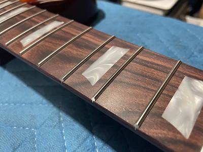

Vortex Neck
Tiltback Gibson® Scale Conversion
Indian Rosewood Shaft
Kingwood Fretboard
1-3/4" (44mm) Nut Width
59 Roundback Profile
10" - 16" Compound Radius
22 Fret
SS6105 Frets
Schaller Locking Tuners (Black)
White Pearloid Trapezoid Inlay
GraphTech Black TUSQ XL Nut
Standard 4-Bolt
Unfinished

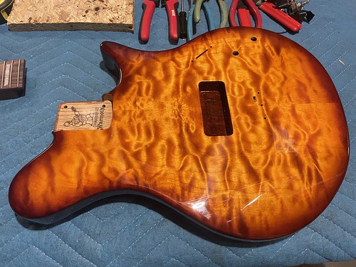

Velocity Guitar Body
Chambered Construction
Roasted Swamp Ash Core
Quilt Maple Lam Top
Rear Rout Control Cavity
P90 Bridge Pickup
Schaller 475 Bridge (Black)
Strat Pocket Shape
Forearm and Tummy Cut Contours
Amber Dye Top Color
Transparent Amber (Burst-over) Back Color
Gloss Finish
QiJack
Stringjoy Strings (Custom Set)
