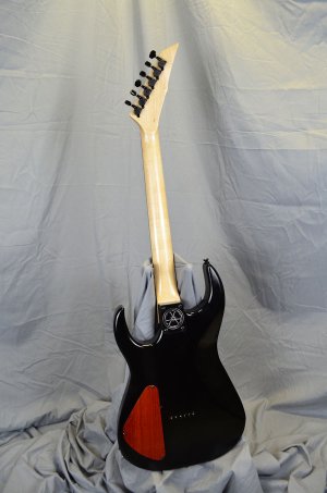

I got everything a few days ago. From the start I wanted to put a wooden control cavity cover on the back so I ordered a piece of Swamp ash. When I got the guitar from Warmoth I immediately started working on the backplate which is now done. I mounted magnets to keep it down and I'll get a photo of that up when I can.
I couldn't grain match it of course but I think it looks good. I need to color match it to the body before finishing. I'm planning on a tru-oil finish.
Anyway, any comments or suggestions I would be happy to hear them. Looking forward to working on this and sharing the experience here. So far I'm having a blast!

Anyway, I'm working on getting the finish on now. I'll get some pics up after I get it done. I will say, The Tru-oil darkened it up quite a bit and its got some beautiful coloring and grain going on. It's made matching the backplate I made a bit tedious though. The neck... Man that thing looked beautiful before I even put any finish on it. But now... It just blows me away how good Tru-oil can look. Never used it on a guitar before and the last time I ever used it was on a gunstock probably 35 years ago. Very happy so far.

I already color matched... Or a least closely color matched the backplate and started finishing it. But I understand what you are saying. It did cross my mind at first but...
Its coming out good. At least to me.

No grain filler on the body per say. It's going to be au-natural as far as the feel. Just a fine sanding and buffing before finishing and sanding of the first coat keeping it wet while I went over it with 2500 grit.
Do you have any pictures on here of your soloist? I's love to see it.
Wow, beautiful work! Glad you figured out how to post photos, because I think we're all richer now for it!
Also, really great job in matching up the cavity cover to the rest of the body. But I'm also of the mind that perfect isn't always necessary and sometimes, you just gotta go for blatantly contrasting ;)
