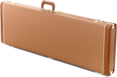

Nope, it was their current Jazzmaster/Jaguar offering:
Thing is, the guitar fits into it at an angle:
As you can see, they added a little padding to the shorter sides of the case to better protect the "butt end" and headstock which is great – you can see it's pretty thin in the vintage case – but that shortens the overall interior length. So, while the body of my guitar fit perfectly in the space allotted to it, the neck neither aligned with the slot in the support nor fit in the space allotted to it. As Cagey says, the body fits snugly in the SKB case, and there's plenty of room for the headstock and the neck is better supported. I'm not wild about the plastic exterior – admittedly, I prefer the look and feel of the plywood/tolex models – but have read that the cases are solid and give good protection.

Watch out, because I believe the case I ordered was the DeLuxe (at least pics of it look identical to what I got) and a Warmoth JM won't fit in it. It had a metal Fender tag just under the handle and a "Made by G&G" (or something like that) tag on the inner compartment lid. You can see both in the pic above. In the end it was no big deal because I was able to return it, but I did pay $25 to do so.
Yeah, sounds like you had the DeLuxe case for sure. That SKB is looking better and better.
