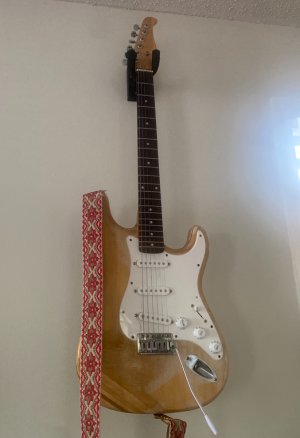

Well, here it is, the reason I’m here, the Strat of Theseus.

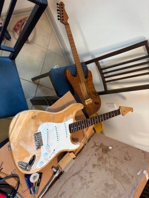

Got this guitar cheap from a friend years ago, but never really played electric for a long time. It sat for a while and the electronics were terrible, so at some point I took the hardware off, sanded down the finish (it was black, full of stickers) and replaced the pickguard with a loaded one from Stewmac. Still didn’t play it much, but it worked.

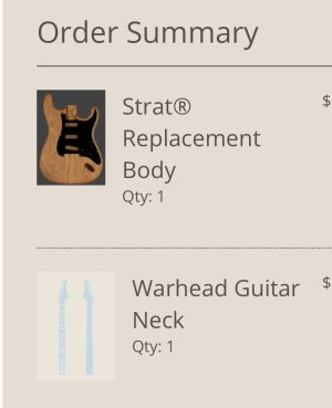

Started looking at body makers and Warmoth came up a lot, being able to really select every single feature of a neck and body is awesome to me (even if I ultimately get one from the showcase if it has what I want when the time comes).
Currently the build list is as follows:

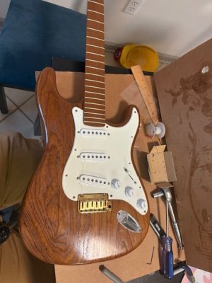

IMG_8759.jpegFinally got my pickups and the TBX controller. After a non-starter with a used set off Reverb that would have saved me a TON (seller had them listed as the wrong thing, they were definitely Fender CS pickups but not Fat60’s, luckily they issued a full refund) I had to wait a bit because I used a chunk of the “saved” cash for my son’s birthday. 😅
Finally picked these up yesterday, slapped them and the TBX controller in (which barely fits in the control cavity on this body) while watching football yesterday. Absolutely phenomenal pickups and well worth the waiting and saving. That first strum was a boarder line religious experience. 😂
Even got to play this morning because I filled in last minute on electric at church. A couple of people on the team commented on the sound.
The TBX really brings the Armstrong mod to life IMO, being able to “boost” the treble in series mode brings some clarity into those settings that they definitely lose without it.
