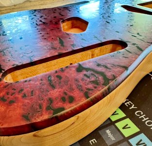

Second build.
Great decision, looks fantastic ! I'm still undecided on the ceramic coating with Rubio, are you using Sheen Plus also ?
Yes. That picture is with Sheen Plus. I still have Ceramic from my last build. The tiny bottles will probably last at least 4 builds. There is actually quite a bit of shine on it in the right light.

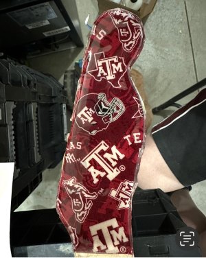

I tried out something crazy for the headstock. Not sure I can clean it up, but you gotta try something to learn something.
Total Boat over a fabric bandana.
Now that's a cool idea if you can clean up the edges. Maybe sand it down so the total boat just sits flush with the sides ?
Yeah, lots of time sanding. We will see. Unfortunately, I think the low E tuner hole is gonna decapitate Reveille's (the dog) head. Should have thought that through better, lol.

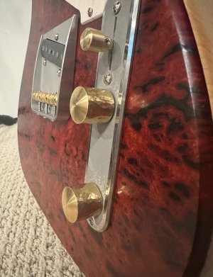

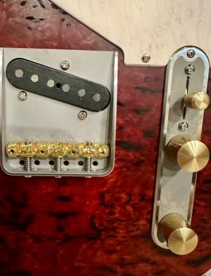

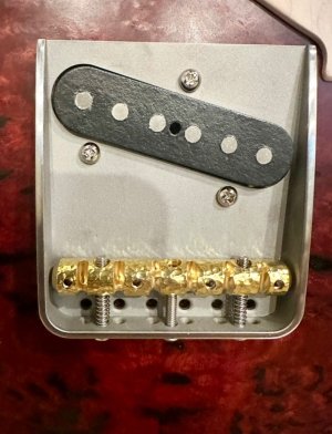

Hardware installed. Other than my crappy soldering, it went well. After Aaron’s video about them, I decided to try the Van Dyke-Harms monolith bridge.

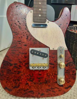

That's a pretty snazzy axe you're building there. I just read through the thread from the beginning, and I'll tell you, the earlier photos had me a little concerned that you would not achieve a true Aggie maroon. But you made it happen. Nice work.
That bridge

Thanks! Angelus Burgundy on that Red Gum Burl really worked out for Aggie Maroon. I have a special Aggie strap being made by Linny Kenny. She does great work, although it can get pricey depending on your design.
I have the short version coming tomorrow.....................MONO FEVER!
now crap grade USPS shipping has bumped it till tomorrow, it has been sitting 20 miles away for 3 days. I am sure margins are tight, but a week and counting is SLOW for a spendy item IMO.

They are so overbuilt they probably need a forklift to move it, lol. The quality is amazing.
