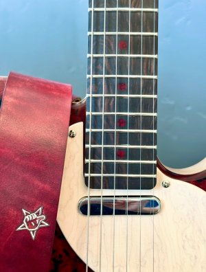

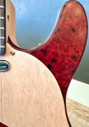

Second build.

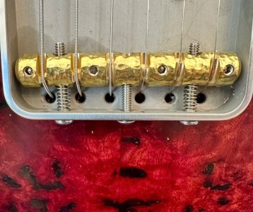

Hardware installed. Other than my crappy soldering, it went well. After Aaron’s video about them, I decided to try the Van Dyke-Harms monolith bridge.
My attempts at Aggifying the neck ended in failure, so I am left without a functional neck. Luckily, it was a screaming deal neck and I can continue doing experiments on it. But for now I have to wait for my new Warmoth neck to arrive to play it, unless I just take a neck off one of my other guitars.
Looking awesome. I've been eyeing those bridges as well, they look incredible. Let us know your impressions after you're done. The wood pickguard is cool, what are you thinking for the finish ?

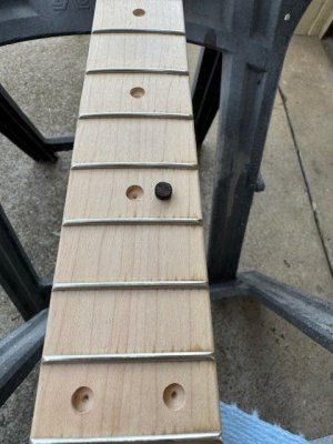

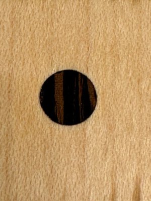

By the way, I have drilled out and replaced round fret markers and it's not too bad. Just use a brad point or forstner bit and have a depth stop. Maybe you could find some dots a little bigger if the holes are buggered up. I found some Rosewood ones to put on a maple neck. Ended up doing a re-fret too.
View attachment 65314View attachment 65315
I did use a brad point. I think my issue was trying to exactly match the size, which was very hard to be exactly drilling the center. If anyone has a fool proof way, I'm open to it. Warmoth uses dot markers which are some sort of clay. If they were plastic, you can drill out the center then retrieve the rest pretty easily. Warmoth markers are there to stay. I still have options to experiment on that neck and will keep trying.

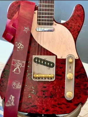

The finish on the pick guard is Rubio. I used a white pre stain then white Rubio 2C, so it's complete. I also put a ceramic coat on it, which I have found does a fantastic job eliminating pick scratch marks. My last Pale Moon Ebony build still has zero scratches with months of playing time.
Uh, when was the last time "Brad" really had a salient point? In my experience he just prattles on and on.................finally, one time, I said "I will thank you to shut your stupid mouth" that really set him off I can tell you!

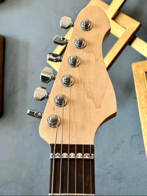

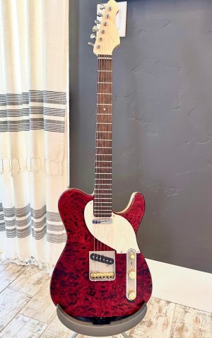

AggieCaster is complete. Including custom Aggie guitar strap https://www.linnykenney.com/blogs/linny-leather-blog/custom-texas-a-m-guitar-strap

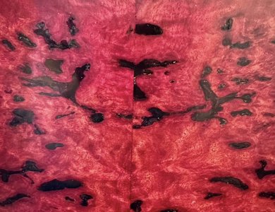

Plays great. Impressed with the Van Dyke-Harms monolith. 51 Nocaster pickups just what I wanted. Maple body is as heavy as a gold brick. Will do the Fender nut again and again. The Australian Red Gum with black epoxy turned out better than I could have hoped for. Maple pick guard adds the right touch of white.

Very nice, the bridge is cool too!

So after a few months what do you think of the Van Dyke-Harms Monolith bridge?
I'm impressed. I was worried about the intonation, but it is spot on. As is the radius for the compound fretboard. Very high quality (and heavy) parts.

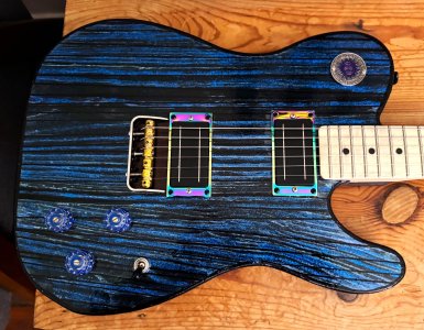

I refinished the entire guitar after carving. I lost about 25% of the overall weight. I could lose more with lighter hardware, but it's comfortable now.
I replaced the '51 Nocaster pickups. The country twang was just not my thing. I put them in because it was a Texas themed guitar, but ultimately I wasn't playing it because I didn't like the tone.
I live in the Boise area so I chose some local pickups, Porter 9T's. Much better for my playing style. P90 growl out of telecaster style pickups.Maplecarve.jpg9T.jpg
I live in the Boise area so I chose some local pickups, Porter 9T's. Much better for my playing style. P90 growl out of telecaster style pickups.View attachment 68859View attachment 68860
Now that's something different ! How does it feel with the cavities against your body ?
