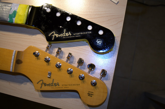

Hmmm.... that's a Warmoth finish already in place on the headstock, yes? You may want to lightly sand the headstock (320 grit) and then give it a blast of shellac (Zinsser Bullseye in rattle-can will do) to give the lacquer something to bond to that it likes.
Generally, shellac is a good intermediate layer to put between an established finish and a new one that may or may not be compatible with the old one. It works and plays well with others.
So:
Sand the black finish
Shellac
Waterslide decal
Lacquer
More lacquer
More lacquer
Still more lacquer
Wait a few weeks
Rub out the lacquer.
