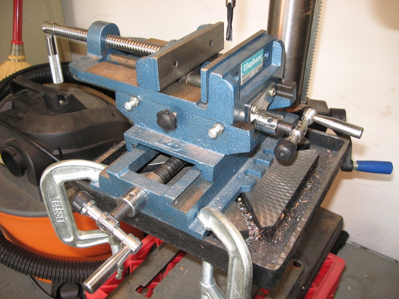

Use a good holding fixture for a drill press, bubble level/align neck. Do not clamp against the fret ends. The W neck has wood screw pilot holes already. Use a new appropriate size, set depth drill bit and a self tapping metal wood insert. Use the drill press with an appropriate driver to manually turn and drive the insert. Coat each insert and bore with wood glue prior to installation. Insert should seat slightly below neck heel level.
