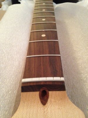

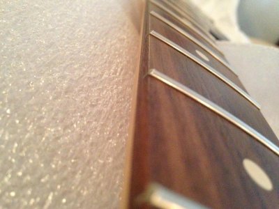

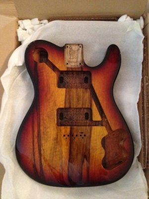

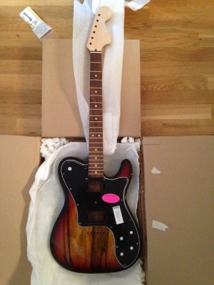

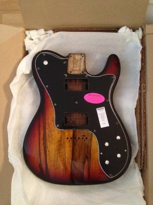

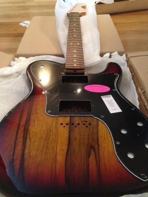

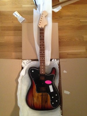

So here it is
CUSTOMBODY
Model: Tele Deluxe
Scale: 25-1/2"
Wood: Black Korina
Bridge: Narrow Strat® Flat Mount
Top Finish: Black-Red-Yellow Burst
Back Finish: Black-Red-Yellow Burst
CUSTOMNECK
Style: CBS Stratocaster®
Construction: Vintage Modern Construction
Scale: 25-1/2"
Neck Wood: Quartersawn Maple
Fingerboard Wood: Pau Ferro
Nut Width: 1-11/16"
Back Shape: Boatneck
Fret Size: 6105
Radius: Straight 9.5"
Fret #: 21
Inlays: Cream Face Dots
Side Dots: White Side Dots
String Nut: GraphTech White TUSQ XL - Standard Nut
Finish: Clear Satin Nitro
I'm going to load it with Lollar Imperials Humbuckers. Low wind in the neck and regular in the bridge and 50s wiring.
This is my first build so my next step is to read some books. Then I think I will dress the fret ends, before I start to bolt it together...
