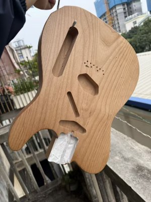

Last month, I met an alder Tele body with a grain that instantly sold me. So… I pulled the trigger and decided to build a vintage-leaning Telecaster.
Vintage Tele® Replacement Body
Alder
One Piece
Right-Handed
Vintage Telecaster®
No Paint
Telecaster® Replacement Guitar Neck
Vintage/Modern
Quartersawn Maple (One-piece)
1-11/16" (43mm) - Modern Medium
Boatneck
Straight 9.5"
21 Frets
Vintage Style (11/32")
Standard Dots
Standard Nut - White Corian
No Finish

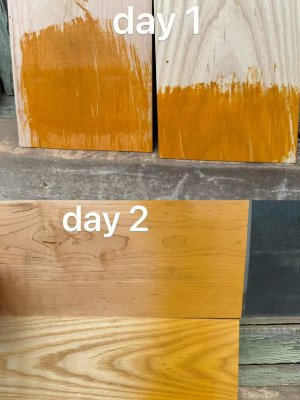

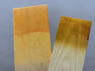

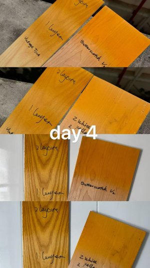

To match the vibe, I also ordered a quartersawn neck. The parts should be arriving soon, so I’m starting early—spent the last 4 days dialing in the butterscotch feel by mixing nitrocellulose.
After a few days of testing, I’m pretty set on a vintage tint look for the neck, and semi-transparent finish to show the grain. I’m still deciding between only a butterscotch coat, or doing a white base first and then blending a yellow layer on top like the vintage 51 or 52.
Updates coming once the package lands.

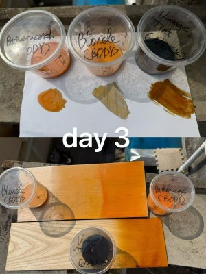

If you look at vintage Teles from that era there is a ton of discrepancy in how amber they got with age and how much grain they show. Don’t hesitate to go with the result you prefer. I quite like the medium tone on the top board in day 3.
100% THAT!!!
I was about to write a similar thing. There's so much variation in the shades of blonde Fender offered in the 50's alone and the decades of reissues, copies, tributes plus differently aged originals have added even more variantion.
So, I agree, go after the result you like.

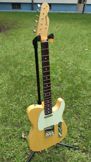

I personally prefer a creamier blonde, more opaque, lighter and less intensity. I originally aimed for an even brighter, "whiter" version, but I'm very happy with the result:
(Build thread here)
I read that Fender never put blonde on alder bodys, I can't really see why, though.

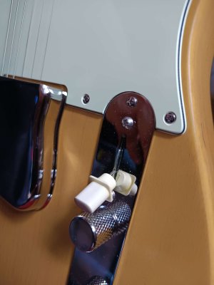

P.S.: Unrelated to the OP but @Hodgo, I think you subconciously inspired me to add a personally aged, white switch tip:
Thank you, looks much better! 😉
100% THAT!!!
(Build thread here)
Welcome to the forum!!! :)
EDIT
Dang I should have started selling those (assuming you’re talking about the one I put on my Hendrix Tele)
Yes. I saw that one, but I didn't (actively) remember that, when I decided to replace the black switch with an off-white one.
I actually bought a cream colored and - just in case the cream didn't look right - a white one, thinking "how hard can it be to age it?". Then the cream one didn't fit the switch at all and while looking for ideas how to age it I somehow thought: "Hey, didn't Hodgo wrote something about aging white plastic parts?"
That's when I noticed, yes, you did and it was even about a white Telecaster "top hat" switch tip. 😅
I used black tea and a hint of curry btw. and it didn't seem to work at all at first, took me a few days and I had to sand them a bit.
If you have a reliable method, then yeah, maybe you should sell them. 😉
I have searched many books, and I did find that there's many different colors and variations from the 1951 to 1952. As you mentioned the medium tone, actually it is under the sunlight, so it looks more creamy in the normal light, a bit similar to Dang's.
If you're doing Nitro, Oxford makes a nice Butterscotch tinted nitro. I ordered an 8oz tin along with some other vintage colors to experiment on different woods with. Looks great on Alder. Also sold in rattle cans if you don't have a gun. Spray light coats until you get the tint you want, then follow with all your clear coats.
https://oxfordguitarsupply.com/product/butterscotch-blonde-semi-transparent/

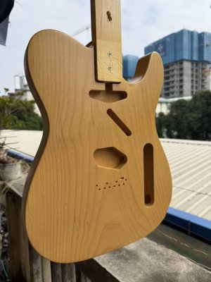

The post told me that the body and neck will be coming in 1 or 2 days.

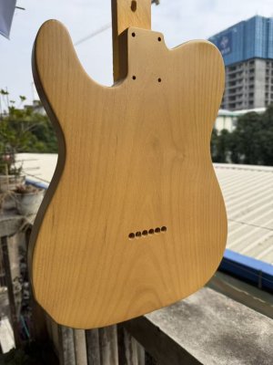

One more round of testing color, with slight adjustment, the butterscotch one is more like yellowish orange, and the photo taken with the phone appears slightly redder than what the eye sees...
Very nice! Almost looks like cherry (alder does that, sometimes) and yeah, one-piece! I'm already looking forward to see the result! 🙂

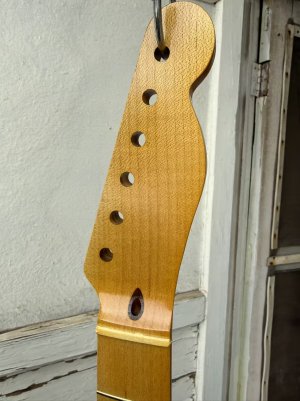

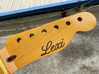

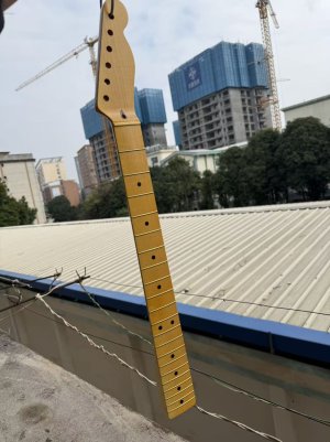

Working on color coats today.
The neck's finishing is surprisingly excellent, with my recipe of vintage tint. (0.18g yellow pigment, 0.6g 2% red pigment, 50g thinned clear lacquer)

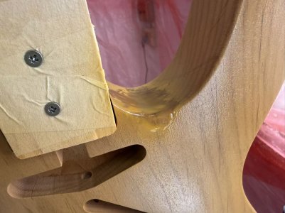

I have met a problem of painting the body when doing the first color coat. I have made a mistake that attempting to get rid a small insect on the coat when I just finishing the painting. Although I have gone through many teaching videos and books that warning about sanding this until the lacquer dried. But I tried to get rid of it during the painting, and I tried to fix it but made it worse
So I have to wait until it dry thoroughly and sanding, try to touching up the paint to fix this issue tomorrow. :cry:
Therefore, I only finished 1 color coat on body today...
