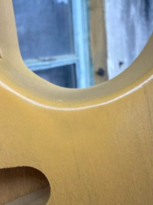

Love the color! I'd leave the insect in, Jurassic Park style. 😜
Yep, if you don't rush and wait until it's dry and sand it, it's easier to get rid of it, but needs patience. I do the same mistake all the time.

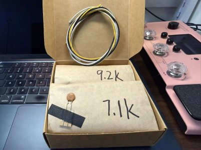

I have receive the pickups, hand-wired by my friend.

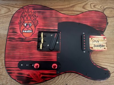

Should still work just fine:
On my Warmoth telly the bridge pickup stands out about 6mm from the bridge plate and the neck pickup stands out 3 - 3,5mm from the pickguard, which itself is 2,5mm thick.
And also your pickups don't look particularly tall to me.
Looking great, very classy. Those damn bugs are a PITA, I finally learned to just walk away and not even look at it until it's dry, then repair and move on. Patience is always the key in finishing, and not my strong point.......

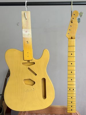

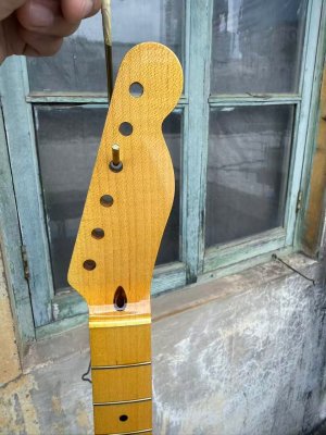

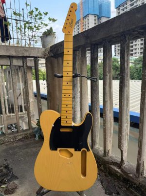

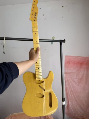

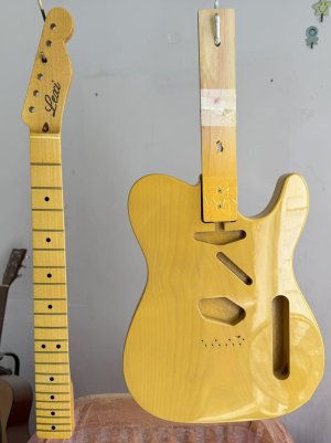

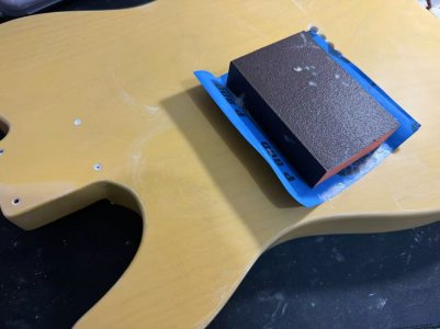

I repainted both the neck and the body this week, completing from sealer to color coats. Since I was using an aerosol can with an external paint-bottle attachment, following the usual recommended spray distance and pass speed only resulted in dry spray. So I stripped off all the previous finish with lacquer thinner and started over using an adjusted spraying method.
Even though sanding after the color coats isn't necessary for nitro finishing, I did a wet sanding anyway to level the surface so that the semi-transparent look more even. And I also decrease the pigment using in neck, it looks lighter now, not like the previous amber color, but it matches the body much better now.
Tomorrow will be the start of clear coats, planning to do 6-9 coats.
Thanks a lot! Patience is definitely not my strong point either. Since it’s my first build and first time spraying, every time I finish a coat I have to peek… and then I start “fixing” tiny flaws, which usually creates even more flaws.:ROFLMAO:
I’m finally learning to just spray, walk away, and deal with everything after it’s fully dry — though I still can’t resist picking it up and observing, then accidents happen.😂

I was planning to wet sand the guitar finish after about 2 weeks, but I never came back with an update. The reason is that around day 10, I touched the body with my hand because the finish felt dry. The next day, I found a lot of tiny cracks in the nitro finish.
Having read some materials, I think the problem was probably a combination of spraying in too much humidity and putting on too much finish when using rattle cans on 11 clear coats, it is possible that the solvents were trapped inside, therefore, the tension in the finish became uneven and caused the cracking.
Also, since that round of finish had too many flaws anyway, I decided to strip it and respray. I adjusted the thinner ratio, improved the color mix, and reduced the number of clear coats: 2 sealer coats, 2 color coats, and 7 clear coats. I also sprayed a test piece on another board with a similar finish thickness, so I could check when it was actually cured enough.
From many tutorials, they recommend waiting about 14 days that dry enough for wet sanding and curing, but even after more than 20 days, I could still make small dents in the test piece with my fingernail. Most of the shallow dents disappeared by the next day, which is honestly one of the magical things about nitro! It wasn’t until almost a full month that the finish mostly stopped denting.
There were still a few small finish cracks appeared on aournd day 20, but I judged that they were shallow enough to sand out, so I finally started wet sanding and luckily, they really did sand out.
The body and neck have both been wet sanded up to 1500 grit. Next step is polishing and final assembly. Hopefully I’ll be able to finish everything this weekend.

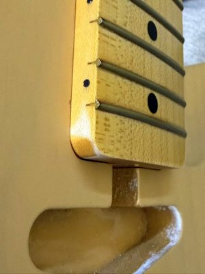

P.S. The Warmoth neck pocket and neck fit are extremely tight in original condition. Even a tiny bit of finish thickness on the neck heel makes it very hard to install. I had to sand the bottom of the neck heel again until I could see a little bit of bare wood color. I’ll see if I can touch it up somehow. Otherwise, I guess this guitar is going relic or vintage earlier than planned!

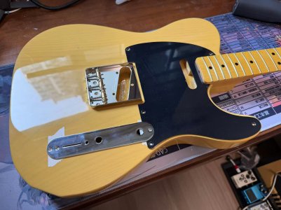

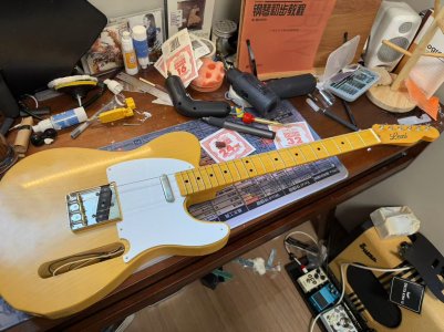

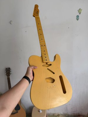

This is how the tele looks like right now, I will do curing this weekend.

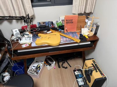

Back to my house and my entertaining room, leaving the "old russian style" room :ROFLMAO:
Finish the polishing process, and waiting to drill the holes (the plate has been reversed by my mistake).

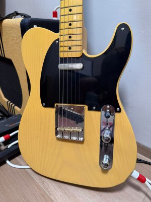

Installing the pick up, and acting like an esquire ( my room was to chaos on that time, cannot find the black guard)

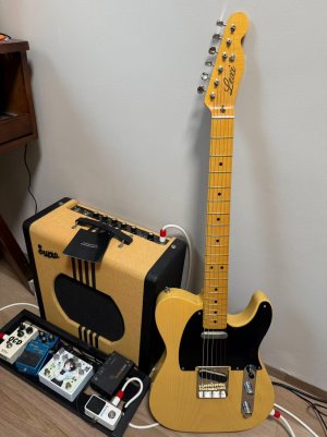

the string must be 1046

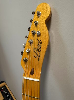

Finish!
