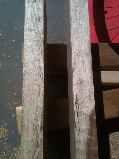

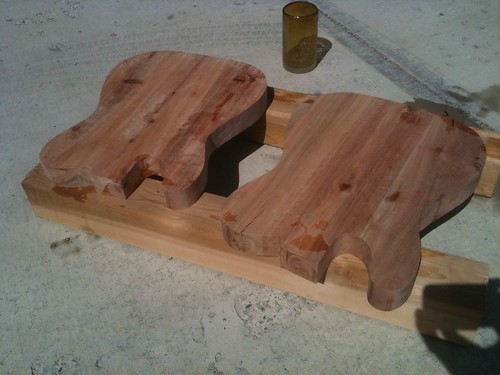

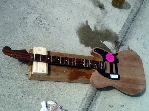

Turned the palletcaster blanks into these:
Thrilled really. Still wondering if I'll fill the voids...
And the cherry blank into this:
Skuse my dust. The flashy sticker on the pickguard is playing havoc with the color balance...
A little frustrated with my blank preparation - could not center the guitar on the middle board of the blank... I hope it won't be too obvious in the finished product.
I think I'm going to try a VERY subtle grey / brown burst on the edges, and pre-treating with ammonia fumes... we'll see. This is the most work I've been able to put in for ages! It's great to be post-call without having stayed up all night.

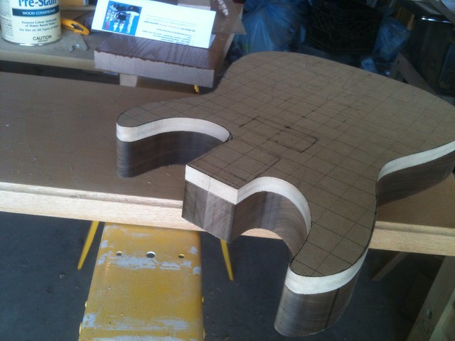

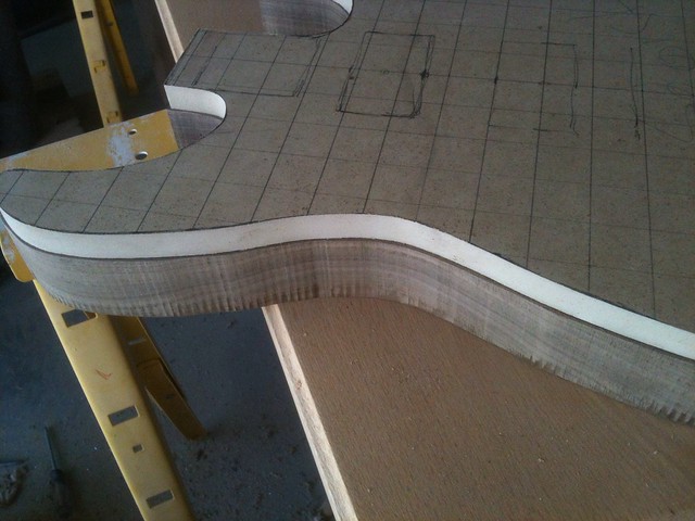

Tools were set up, so I went ahead and cut / routed the wenge and 1pc walnut tele bodies.
You can see sapwood and the router-sled-planer marks on the walnut one.
This is raw off the router. Really no tearout on the walnut, cherry or pallet casters - I think the trick is a combination of cutting close to the line when you're parallel to the grain, slow but constant rate of feed, and a sharp stable bit. I don't sand, and wish I had a spiral trim bit...

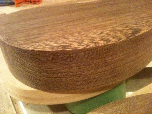

The wenge had some moderate tearout (more like splintering - it's completely unlike any other wood.) Only on the outside of the lower bout, and nothing a bit of sanding can't fix - it won't show.

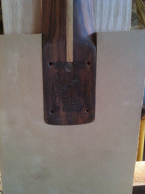

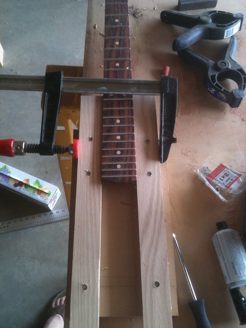

Made a neck pocket template, since no one has anything good to say about StewMac's
Freehanded the contour with the 1/2" collet router bit... got lucky.

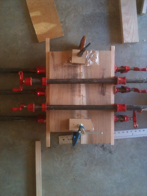

Cut and glued the Koa. Too bad - the spalt was really nice! Never knew what hit it.
