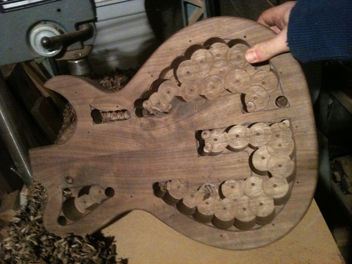

So pre all this, 6lbs 10z without the aluminum plates (which add about a pound each).
Tight corners with 3/8" bit.
1.5" forstners are a wonderful thing. 4lbs 11oz at this point.
I think I went too deep... Never fear! the back is covered! 4lbs 4oz here - and pickups / neck left to do, and may even relieve the back of the middle part some. So all in all a 2lb 6oz diet - not trivial.
Didn't fuss too much with the inside part looking good - I wasn't about to make a template for this...
Next: pickup routs, transfer to aluminum, make tailpiece and wait for the cash to roll in to buy parts and a neck.  :glasses9:
That's a pretty ambitious piece of work!
I'm surprised you used a Forstner to clear the majority of it. They're pretty easy to burn up, or at least lose the temper on. They're kinda pricey to waste that way. A good carbide-edged mortise bit chucked into a router will chew on that sort of thing all day and just smile at the sky. I understand the desire for expediency, but I wouldn't sacrifice tools for it. They'd likely come in handy later.
But, you can't argue with success. You're getting where you need to go. That's going to be a great body.
The 3/8" forstner didn't enjoy it's job, but the 1.5" loved it. Barely got warm. Chewed into the wood like butter. It went really quick, and was a safer way ofgetting lots of material off quickly. Plus, no template required. (I wouldn't ever freehand with a router when that much thickness is involved.
