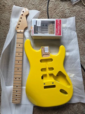

About an hour ago, it arrived - photos attached.
As expected exceptional job. Body feels quite light - alder - but I won't count those chickens until the fat lady sings. 🤣 Assuming it all aligns correctly, no complaints.
Okay the pachyderm in the corner. Not in love with that colour. It's what I ordered, and after discussing it here, it's what I was expecting. Not the end of the world. I'll just have to live with it... wishing I'd gone with trans purple, now. 😁
I'll start 'the build' in the morning.

Well...

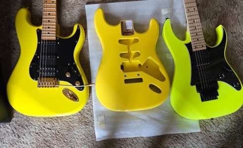

The graffiti yellow looks great! I've been thinking of ordering my next Warmoth body in that color. It would go well with a contoured heel, maybe if/when that's rolled out...
I love that highlighter yellow or green on that Ibanez on the far right.
Yeah, that's the colour I was hoping it'd turn out to be when I ordered it. That colour is actually called Desert Yellow. It's 'YELLOW', I guess there must be some green in there for the camera to 'see' it?
The 'Strat' is a guitar I had built 30 years ago. It's donating it's electrics and tuners. I was hoping GY would at least match that.
It's all subjective, isn't it? I suppose the mistake I made was trying to replicate the old guitar colour? If I'd gone with a completely different colour, I'd have been overjoyed.
Like I say, my own fault.
It does have the contoured heel, by the way.
I'll post the specs later.
Well, looking at the picture with the three colors next to each other, I totally understand ordering Graffiti Yellow and expecting it to look like the 30 year old guitar on the left, because they look very similar in that picture.
But how you expected it to look like that greenish neon-color on the right... I don't get it.
But all that aside I think it'll look good!
And I'd be very curious how the old guitar looks under that pickguard: The color might have looked different 30 years ago.
And you know the old saying:
If life gives you lemon-colored guitar bodies... or something like that. 😉

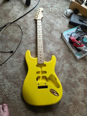

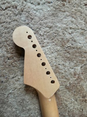

Hiya peeps,
Apologies for the delay in updating the thread. Life 'n' all that.
So far, neck and body have met several times, tuners fitted, strap buttons and jack plate attached... and the claw screws have been run in & out a couple of times.
Next step is to sort out the scratchplate. The old one isn't acceptable, so a blank has been acquired, just needs holes 'applying'.

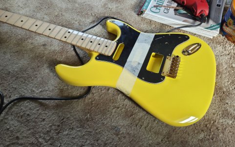

Hiya chaps... and chapesses - if there are any there, feel free to shout up.
Captain's log stardate...

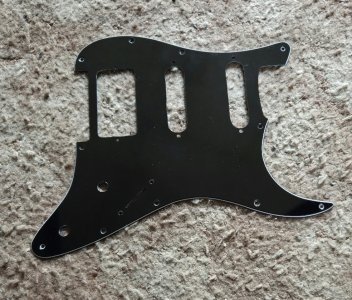

Since my last report, acquired a blank, black Strat scratchplate, which my dear old Dad did a sterling job of putting the required holes in.
Reason being, my old 'plate was cut for the neck overhang on my donor guitar, I need the humbucker a few mm closer to the bridge, and my eyesight is shot.
This morning, presented the 'plate to the body, with bridge temporarily installed, aligned, 'secured' and proceeded to drill the mounting holes.
Next up, you might be able to see in the photo that I now need to shave a bit of wood at the back edge of the 'bucker cavity. Don't panic - it was expected. It's not a 'Warmouth issue'. It's a 'somebodyelseuk knows better than Fender' issue.
Before anyone asks... in my world, 'that'll do' won't do.
PS: I'm warming to the colour shade. 😉
