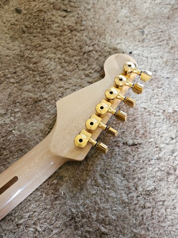

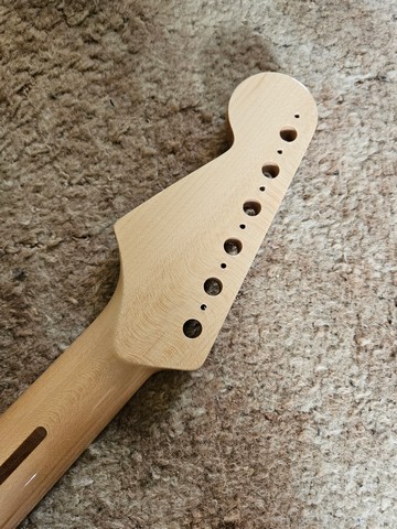

Started with the job I was dreading most - drilling the pin holes for the (Sperzel) tuners. Paid silly money for one of those guides, a few weeks back, took a deep breath and...
Fitted the tuners...

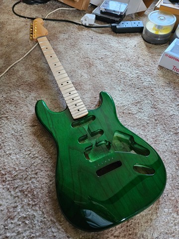

Then tested fitted the neck to the body...
All gone to plan, so far. Relieved to have not screwed up the tuner stuff. That's enough stress for today.
Only (minor) fly in the ointment is that I had the body done with the heel contour, and bought the appropriate screws in the order. One of the screws has bottomed out in the neck hole, so it'll need a mm or so cutting off the end - the beauty of being 'old school' and not using power tools other than a drill is I screwed the neck screws in using a screwdriver and didn't end up forcing the screw through the fingerboard. :)
As long as the bridge lines up with the neck, it's all downhill from here...
