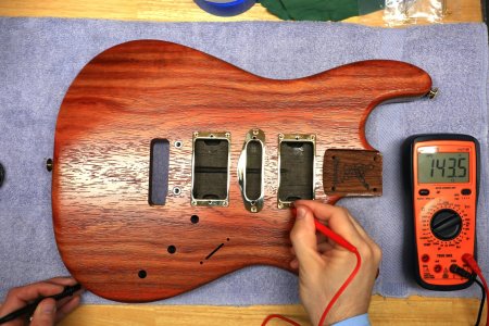

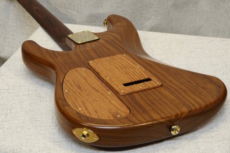

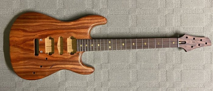

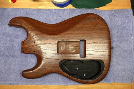

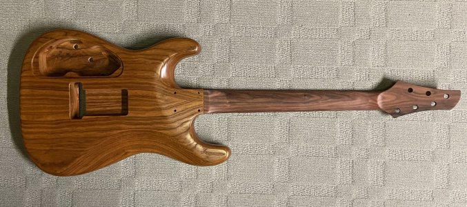

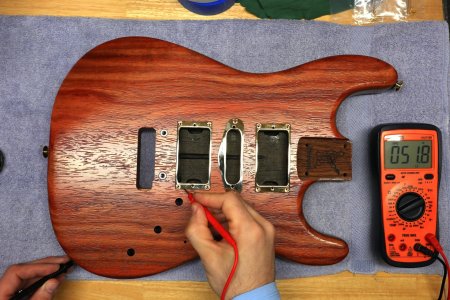

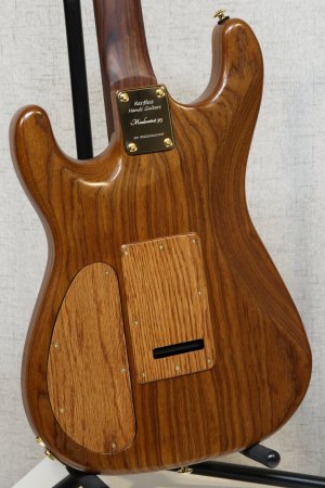

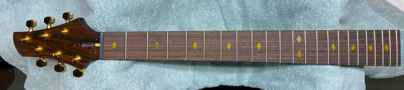

The parts arrived a little over a month ago and did not disappoint (see attached pics)!
