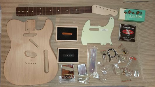

The kit contains:
- Body made of american red alder, "vintage shaping", unfinished
- One-Piece-Maple Neck, 7.25" radius, unfinished
- Preslotted TUSQ Nut (not installed)
- Heel-adjustable truss rod
- 21 frets (2,1mm x 1,1mm)
- Nickel plated KLUSON Deluxe Vintage Tuners (Double Line Stamp)
- Vintage Bridge with Brass saddles
- Complete hardware incl. mounting screws
- Black pickguard
- Rockinger Telly Rhythm and Telly Lead Pickups
- All electronic components incl. US 3-Way-Switch and Orange Drop Capacitor
- 1 set of Rockinger Strings
For an upcharge I ordered the neck with rosewood fingerboard. Also I changed the black pickguard to a mint green one at no extra charge.

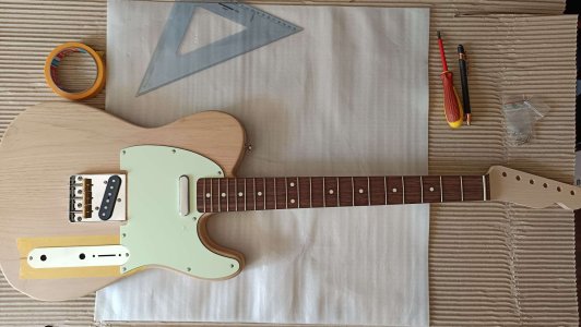

As for the quality, so far I am pleased with the kit, although there is a bit more to be done, than I am used to:

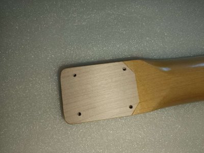

The neck comes without mounting holes and the nut needs to be installed, but both worked well. One appreciates thought, that Warmoth offers mounting holes as standard option.
The only thing that bothered me so far is the routing of the bridge pickup: I don't know if it is because of the bridge, or if it is true to vintage correctness or just a mistake, but the bridge pickup routing could have been a millimeter closer the the bridge mounting holes. Now it's a bit of a press fit which I'm sure it shouldn't be. Also something I appreciated with Warmoth.

Its a bummer the bridge doesnt fit well. However, I will mention that there are about a million variations on the Tele bridge so that specific bridge might not be good fit and if you are looking to upgrade it, then you might find that a different manufacturer might fit better for that route.

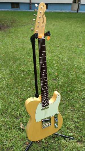

Progress has been made.

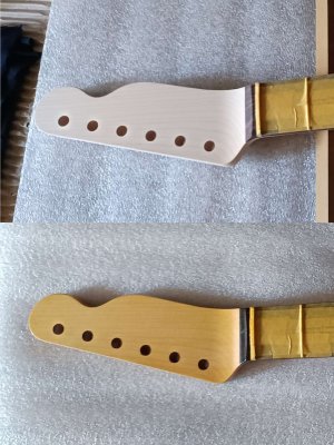

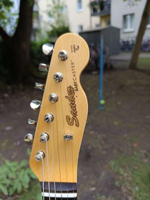

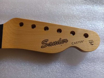

Here's a before and after of the headstock:
As you can see, the aged vintage yellow neck finish darkens the wood quite a bit.
With the neck finish kit you get two bottles, a neck colour coat of which I put 4 coats on and a colourless neck top coat, of which I used 3 coats plus a couple more just for the headstock, because...
... I put a golden silk-screen logo on it, made by the wonderful people of GuitarDecadence.com, which I highly recommend!
Instead of Fender I used my infant sons middle name, the blurred out word before caster being his first name, which would be too much information for the internet. Let's just assume it's a Babycaster in this thread.
"Richtig dufter Typ" means something like "really nice/cool guy". I know tellys usually don't have these small decals, but they were part of it and I don't like to waste things.

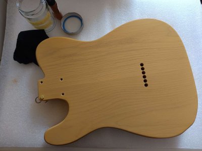

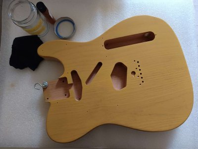

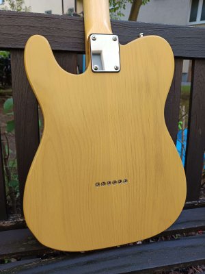

Here are some shots of the body before the clear coats:
With the dairy blonde finish kit I got 6 little bottles! Two bottles of colour base, two bottles of white base, an empty bottle to mix those two und a bottle of Top Coat Extra Gloss.
I ended up mixing white and colour 2:1 and using up almost all the white. It is possible to get more opacity in less coats, but I read that very late.
It is recommended to wait a week after the last clear coat before putting it all together, which means by thursday I can start to screw it together.
All in all I like Wudtone and I think it's worth the money, I think it's absolutely possible to make (almost) professional looking finishes with their kits, but maybe not the first time!
I didn't take the grain filler, I didn't expect is to look perfect and/or new and I'm generally satisfied with the results. But maybe I would've done some things different.
I will use Wudtone again.

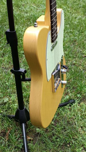

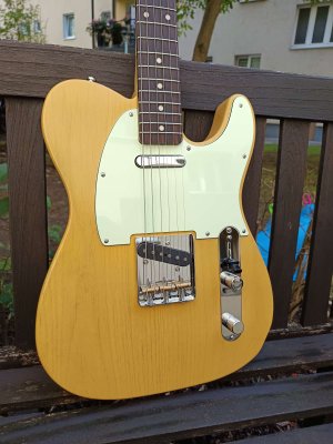

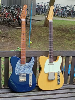

Alright, here she is, sitting next to the Teilecaster.
And yes, I bought one of those ashtray covers just for shits and giggles. It makes the guitar unplayable :ROFLMAO: but I always wanted to have one of those.
She's pretty light, 3.28kg or roughly 7 ¼ lbs, partly because the wudtone finishes barely add any weight.

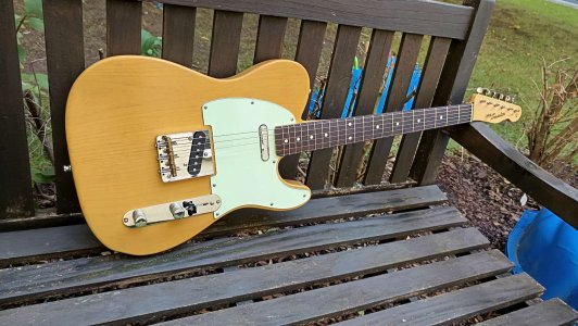

While I really enjoy playing her, I'm also kinda relieved:
I kinda came to terms with being a Telecaster fan now, but spaghetti frets, 7 ¼" fretboard radius, uncontoured, sharp edged body and a normal wound bridge pickup... this all together is almost a little too much Telecaster for me, so there's still hope for me! 😅

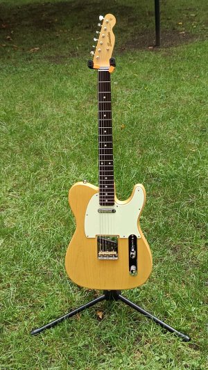

This final picture shows the color of the body best, it was again tricky to get it right on camera:
EDIT:
Btw.: I expected the new guitar to sound a little warmer/darker, you know, rosewood fretboard, alder body... the somewhat warm and buttery appearance... But I was wrong!
It seems like the difference between the fatback profile of the roasted maple neck and the thinner, more normal profile of the rosewood neck is absolutely dominating all possible tonal differences.
Which is an excellent realisation, when the next guitar you're building is made of poplar! 😅
Thy are both very nice! HOWEVER, I beg you to install a cream or black pickguard on the blue one. The one on there gives me a headache. Hurry please!!! I am having trouble sleeping.
