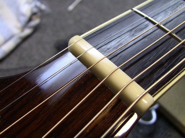

For those who are using Vortex and Warmoth necks with non-locking tremolos:
  - would you mind showing me how the nut looks like on your neck ?
  - do you use the tremolo on it, and if so do you have tuning stability issues  as soon as you use it ?
The only way I got my Soloist/Vortex build with Wilkinson VS100N to stay in tune was eventually cutting the nut like Gibson does which leaves as little thickness as possible at the top of the nut:
Anything else, including the Warmoth-cut nut (and the dozen I made similar to it), was disastrous in terms of tuning stability. The other Strat I built with the same tremolo but Strat neck/6-inline locking tuners was rock solid even with heavy whammy bar use.

Unfortunately I don't have pics right now of the guitars that I've done for trem users. I fully agree that you may get better results with the strat style head. Basically the method I used was to have the nut slots no deeper than half the string diameter, (That's the way that used to be considered proper for all guitars.) and a lot of fall away on the tuner side. By fall away I mean the curve in the nut on the side facing the tuners. Plus, the slot should widen out as it leaves the top of the nut on the curved side. Something like this;
And the slots should be just a hair wider than the string, not enough to allow lateral movement, but enough to prevent binding.
Thanks PhilHill, 'fall away' is what I meant in much poorer terms haha.
I don't think I tried to widen the nut slots at the exit, I had so much fall away that there wasn't much to widen anymore, but that's something I can try doing if go the 3+3 route again.

Yes, fall away is little used term anymore, so no surprise or fail there. It was originally a term used by boat builders. It's kinda like the term "Electric Spanish" which is what the ES in Gibson names means. It's proper, but little used. Perhaps a combo of this type of slot on a Strat style nut would be the best. I can't remember for sure, but I think I might have tried that too before. Getting old is hard. Especially when you don't like cheese with your whine.
