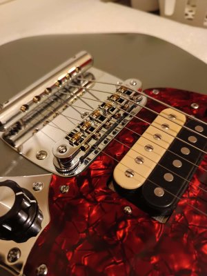

I bought a Rockinger Bellbucker for the bridge pickup position, while the neck pickup is from my very first electric guitar, which I have for 30 years and two days now (since Halloween 1995, my 12th birthday
The wiring I chose, with the switch closer to the neck pickup being a 3way pickup selector and the one closer to the bridge being a parallel/split/series switch for the humbucker turned out really nice and very useful!

Talking of weird: That Mustang Tremolo! I'm not sure if I just set it up wrong or if that thing is just... wrong... I managed to set it up so it's ok as a down only-trem, but if you pull it up, everything get's stuck, with ALL the strings being (not) close (enough) to a halfnote higher until you push it back down again. And it's so sensitive, that this already happend by accident!
However, I like that it's different. If all my guitars were the same I wouldn't have them all!
