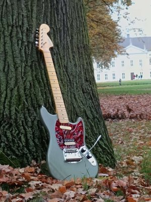

I finished my Mustang last weekend and... where do I even start?

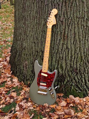

Well, maybe by linking the build threat 👉 here👈 and by posting a pic of the completed guitar:
What are we looking at?
Mustang Guitar Body
Construction:
Solid
Core Wood: Poplar (BONUS one-piece!)
Lam Top Wood: No Lam Top
Right / Left Handed: Right-Handed
Control Cavity: Top Rout
Multi Pickup Top Rout: Mustang Top Rout
Bridge Rout Type: Tremolo
Bridge Rout: Mustang Tremolo w/ Mustang Bridge
Would you like Warmoth to install the bridge studs?: No
Mounting Holes: Standard 4-Bolt
Neck Pocket Shape: Strat®
Body Contours: Forearm Contour, Tummy Cut
Paint Category: No Paint
Finished with Wudtone Lady Marion.
Mustang/Jaguar CBS
24" Scale Replacement Neck
Construction:
Modern
Shaft Wood: Maple
Fretboard Wood: Maple
Nut Width: 1-5/8" (41mm) - Narrow
Neck Back Profile: D
Fretboard Radius: 10" - 16" Compound
Number of Frets: 22
Binding: None
Fret Size & Material: SS6150 - Wide & Tall (Stainless)
Tuner Hole Size: Schaller/Modern Fender/Sperzel (25/64")
Inlay Shape: Standard Dots
Inlay Material: Black
Side Dots: Black Side Dots
String Nut: Standard Nut - GraphTech White TUSQ XL
Neck Heel Shape: Strat® Shape
Finish: None
Finished with Wudtone Vintage Neck Amber.
Also:
- Custom Warmoth Pickguard in Ruby Pearl
- Neck Screws, Neck Plate and Neck Plate Pad
- Modified Mustang® Bridge
- Mustang® Tremolo Tailpiece
- Mustang® Control Plate
- 2× Switchcraft Slide Switch, On-Off-On
- copper shielding
all from Warmoth...
The tuners (Kluson roundbacks), headstock decals, string trees, strap buttons (Schaller S-Locks), 500k log pots, wires, caps, the jack and the knobs I had already lying around.

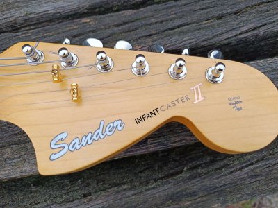

(Btw.: I edited the headstock decals in the pics for the same reason I did on my second telly build: TMI for the internets...)

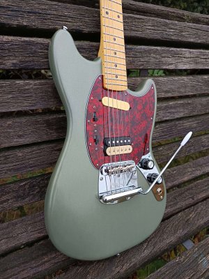

I bought a Rockinger Bellbucker for the bridge pickup position, while the neck pickup is from my very first electric guitar, which I have for 30 years and two days now (since Halloween 1995, my 12th birthday ;)).
The wiring I chose, with the switch closer to the neck pickup being a 3way pickup selector and the one closer to the bridge being a parallel/split/series switch for the humbucker turned out really nice and very useful!

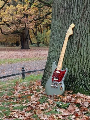

Today we took a little walk in the park together.

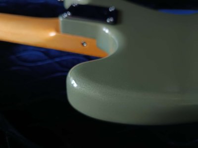

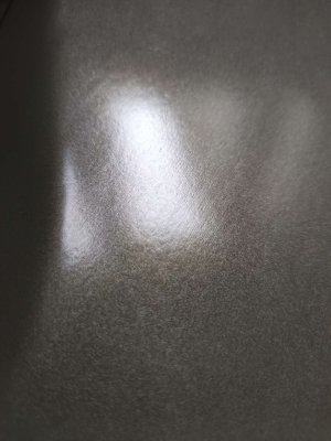

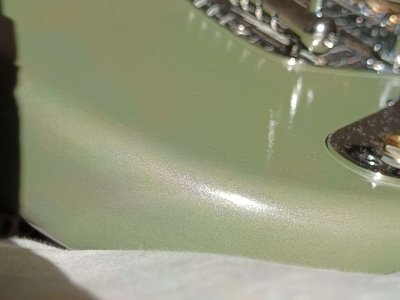

A word on the finish:
I like it, although it turned out very different than I expected! And it's on of those finishes, that looks extremely different, depending on the light: Sometimes it looks like Metallic Surf Green, sometimes like Lake Placid Blue with a yellowed clear coat; sometimes it looks like a metallic version of olive drab; sometimes it looks more like a dark, smokey silver, than a green!
As I said in the build thread, the finishing kit consisted of 2 bottles of green base, 2 bottles of white base, half a bottle of "silver highlights" (small flakes) and a bottle of clear topcoat.
I started with applying 3 think coats of green mixed with white 1:1 to get a solid base. Using a 2:1, or 4:1 mix or skipping the white base all together and using only green might have worked as well for a darker finish.
Then I mixed green with the silver highlights 2:1 and applied 3 thick and 2 thin coats, followed by 5 thin clear coats.
It's not as smooth and perfect as it looks in the pictures, it's more like this:
But I think it's nice to the touch and it looks good, I actually hope it'll sink even more into the pores over time.
I'm always kind of "flexible" in my expectations and while the finished guitar looks different, than I originally imagined, I really like the result! So Wudtone made me happy again.

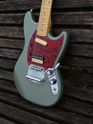

How does it play/sound?
First of all: 24" scale feels weird if you're not used to it. I can switch between 25½" and 24¾" without feeling a huge difference, but 24" is something else somehow.
Maybe the D profile is adding to that, but I have to play it more to be sure.
Talking of weird: That Mustang Tremolo! I'm not sure if I just set it up wrong or if that thing is just... wrong... I managed to set it up so it's ok as a down only-trem, but if you pull it up, everything get's stuck, with ALL the strings being (not) close (enough) to a halfnote higher until you push it back down again. And it's so sensitive, that this already happend by accident!
However, I like that it's different. If all my guitars were the same I wouldn't have them all! 😅

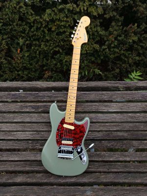

And I think it looks killer and is fairly light:
3.34kg or 7.36lbs
I have just one little regret: Jade dots would have fit perfectly...
